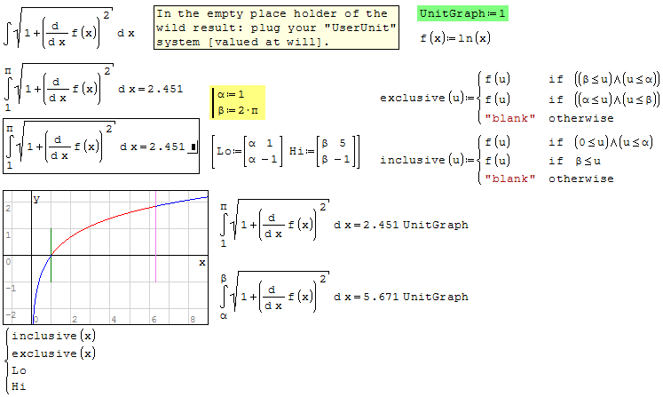

Hello David,
Many Smath users are "pro" using the unit system, not me because unit system
does not pass QA [Quality Assurance]. From a wild result [not unit affected],
you can post-add your own system.
UserUnit.sm (13.41 KiB) downloaded 1202 time(s).

Smath crashed, Oh !
More collabs will visit to help you rescue your Smath.
Here is the work sheet in compacted image.
Hope it open, no crash ?

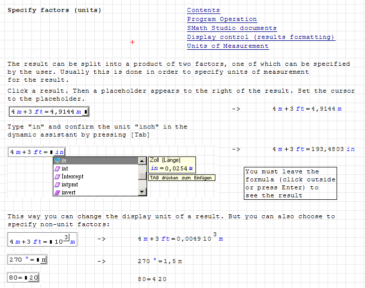

I cannot create this system of units by changing the constant.xml and units.xml sheets because the underlying structure is different. I have also created worksheets with unit definitions that work, but the software wants to produce the results in SI units, which is really messy. I need to have the results in the native units I have devised.
Maybe, it is as easy as typing the unit you want for the result in the square black placeholder?
2017-05-21 21_30_24-SMath Studio 0.98.6179 - [Section operation units.sm].png
Section operation units.sm (21.32 KiB) downloaded 1194 time(s).
