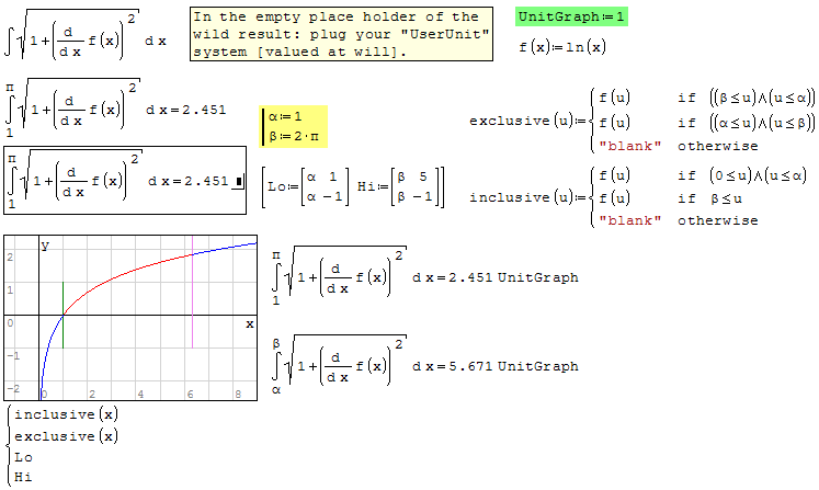

Hello David,
Many Smath users are "pro" using the unit system, not me because unit system
does not pass QA [Quality Assurance]. From a wild result [not unit affected],
you can post-add your own system.
UserUnit.sm (13,41 КиБ) скачан 1202 раз(а).

Smath crashed, Oh !
More collabs will visit to help you rescue your Smath.
Here is the work sheet in compacted image.
Hope it open, no crash ?

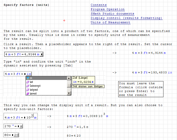

Maybe, it is as easy as typing the unit you want for the result in the square black placeholder?
2017-05-21 21_30_24-SMath Studio 0.98.6179 - [Section operation units.sm].png
Section operation units.sm (21,32 КиБ) скачан 1194 раз(а).

My own units like this:
(me:=1)≡"mass of electron "
(e2:=1)≡"electrostatic charge squared"
(eemax2:=1)≡"electromagnetic charge squared"
(λC:=1)≡"Compton wavelength"
(Fq:=1)≡"quantum frequency"
Variable name can only be letter(s), some symbols, underscore
Variable names can't be mixed with arithmetic operators.
So, if you have a result about the mass of big electron, per say
mybigelectron=123456.789
in the right most place holder of mybigelectron=
paste me from the definitions upstream the document
to read => mybigelectron=123456.789me
Something like: 2 onions + 1 carrot= onion soup
1 onion + 2 carrots= carrot soup.
I have more recipes ! Cheers, Jean
... ≡ is the fat = [Ctrl+=]

That's what I suggested "paste in the rightmost place holder"
paste the unit as written in "Writer region" ...+++ more symbols.
