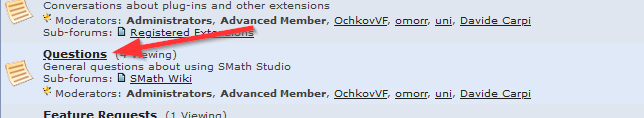

To start a new topic:
1. Click on the section relevant to your needs:
2. Click on the "NEW TOPIC" button on the bottom-right corner
3. Write your post and submit it(optional, before posting you can use the preview button to get a preview of the formatting/composition)
Oscar Campo 5/6/2024 6:36:00 PM, RegC 5/7/2024 1:43:00 AM
