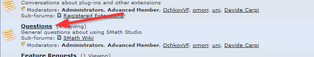

1. Click on the section relevant to your needs:

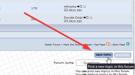

3. Write your post and submit it(optional, before posting you can use the preview button to get a preview of the formatting/composition)
