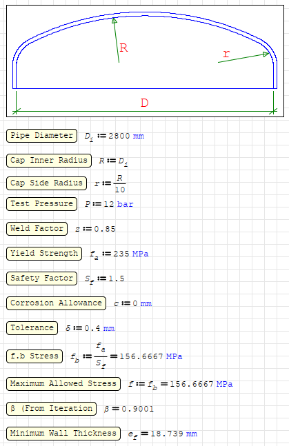

Basic torispherical head thickness finding for pipe testings.
Sample also contains a primitive drawing with 2D plot.
Calculation is based on EN13445-3 standard.
torispherical_cap.sm (44.91 KiB) downloaded 1522 time(s).
torispherical_cap.pdf (198.3 KiB) downloaded 908 time(s).

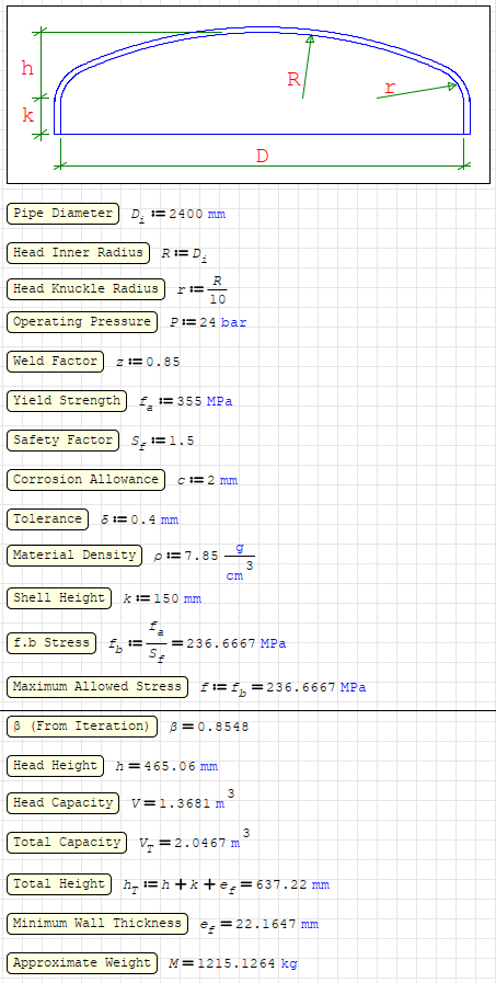

Height, Volume, Mass calculations are added.
Drawing is slightly revised according to those.
torispherical_head.sm (69.19 KiB) downloaded 1537 time(s).
torispherical_head_v2.sm (70.99 KiB) downloaded 1523 time(s).
