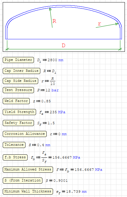

Basic torispherical head thickness finding for pipe testings.
Sample also contains a primitive drawing with 2D plot.
Calculation is based on EN13445-3 standard.
torispherical_cap.sm (44,91 КиБ) скачан 1523 раз(а).

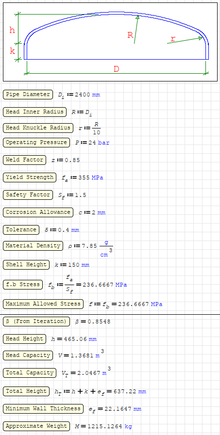

torispherical_cap.pdf (198,3 КиБ) скачан 909 раз(а).PS: h calculation corrected version (for volume and mass):torispherical_head_v2.sm (70,99 КиБ) скачан 1524 раз(а).
