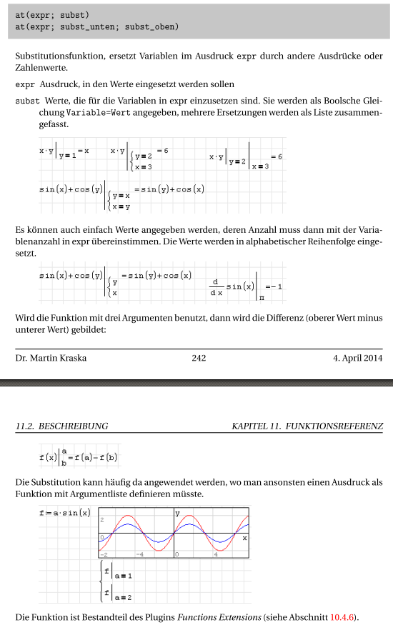

The FunctionsExtensions plugin provides the at() substitution function with special operator formatting. This exploits the symbolic storage of the expression in the variable g.

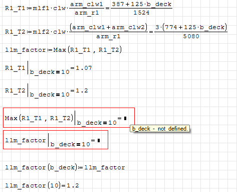

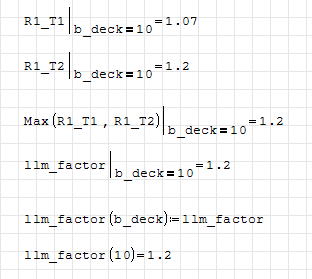

Hi everyone!,
Not sure if this would be a bug but at() function does not seem to work while evaluating fuctions that include Min() or Max().
See workbook and photo attached.
Thanks!
Martin Kraska 17.04.2014 18:08:00, Davide Carpi 19.04.2014 03:42:00
#6 Опубликовано: 17.04.2014 11:10:56

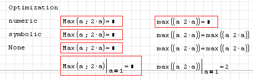

Confirmed. This is bug of Min() and Max(). Apparently they always try to return a numeric result, regardles of what the optimization setting is. If they would return themselves with evaluated/preprocessed arguments, at() would work, as the example with max() shows.
