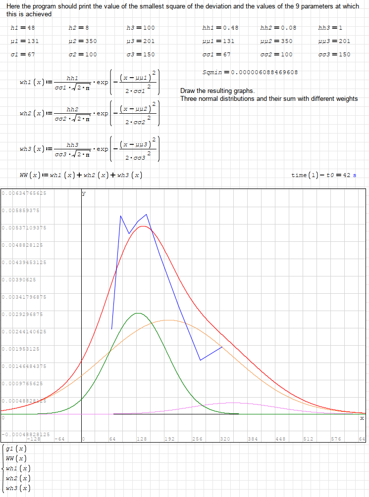

Now only one question remains. Iterating through 9 parameters requires a lot of time. And the calculation is carried out with an accuracy that is superfluous for my purposes.
Sq and Sqmin are calculated with an accuracy of 15 decimal places. And I would have more than enough 8 or 9 digits after the decimal point.
This would significantly reduce the calculation time.
And here is the Pearson correlation coefficient I have 0.9999, whereas I would have more than enough 0.9
Here is your Sq and Sqmin calculations.
I have noticed Sqmin make a peak to lowest and rise again at some point.
I coded to find those points range within first iteration.
This is done by evaluating variables one by one, not all at one.
All iterations are taken under 5 seconds on my PC.
Please inform if this results are enough for you.
eng-min_rev_fast.pdf (617,87 КиБ) скачан 879 раз(а).
eng-min_rev_fast.sm (40 КиБ) скачан 1177 раз(а).
#24 Опубликовано: 15.06.2021 19:13:29
A revised Sq and Sqmin calculations of previous.
All iterations are taken under 25 seconds on my PC.
Sqmin is dropped to 6x10^-6. And now I am out of ideas.
eng-min_rev_fast.pdf (671,47 КиБ) скачан 826 раз(а).
eng-min_rev_fast.sm (47,31 КиБ) скачан 1234 раз(а).
