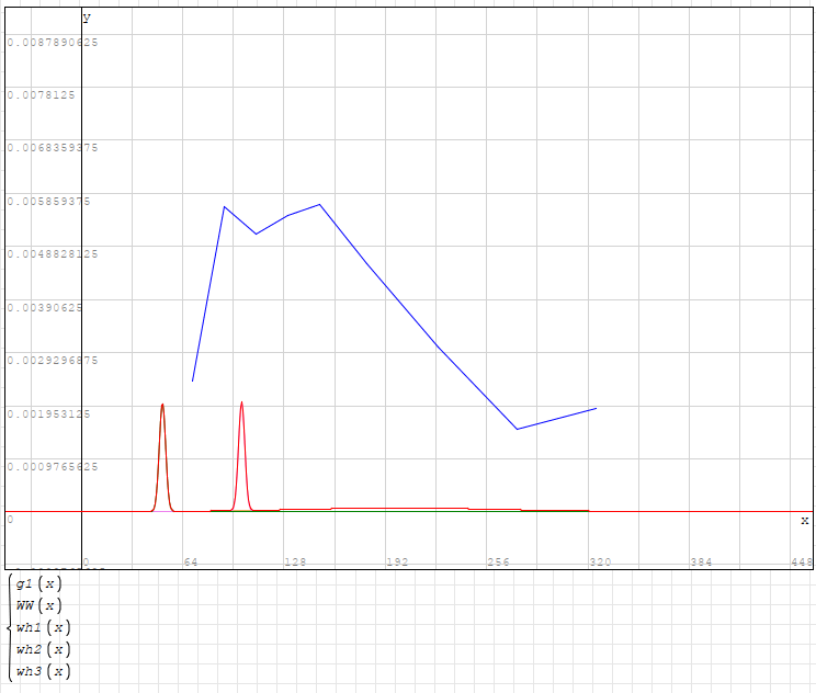

There, for some reason, the search of options stopped at the value of hh1 = 0.01, respectively, and hh2 = 001, hh3 = 0.01. That is, h1, h2, and h3 were only checked when the value =1.
Whereas I expected that the iteration of options should reach hh1 = hh2 = hh3 = 1, respectively h1 = h2 = h3 = 100.
For other parameters, it also seems that the search for options has not reached the end.
That is why the resulting graph shows a complete mismatch between the original data and the approximating formula.

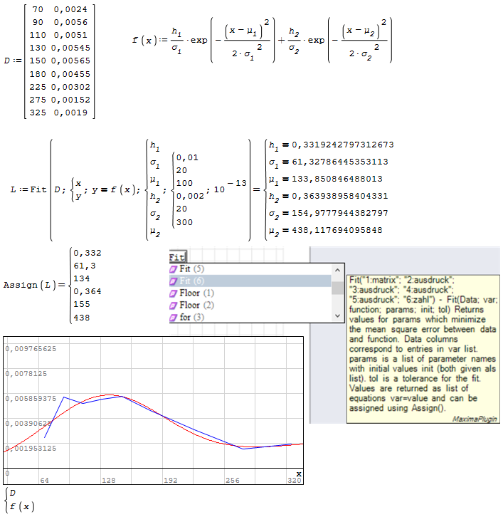

fit.sm (136,38 КиБ) скачан 1181 раз(а).

I decided to take a simpler case for now, when we approximate the sum of two distributions.
With some tweaks, the time limit can be circumvented. Although I haven't tried the Fit function yet. Perhaps it will give you a gain in time.
Can you tell me how to limit the accuracy of the calculations? There Sq is calculated with an accuracy of 15 decimal places, while 9 digits are quite enough for me. This would give you a gain in time.

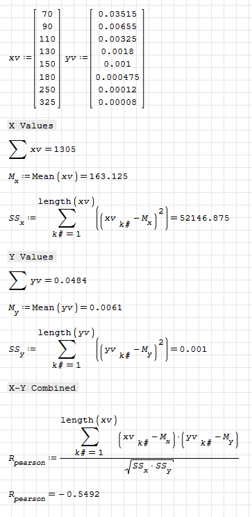

Below you can find how to calculate Pearson correlation coefficient.
To sum all elements of a vector, you can use sum(1).
To operate piecewise you can use sum(4).
You can also use for-loop and while() to calculate something in a vector/matrix. Not demonstrated here.
pearson.sm (8,9 КиБ) скачан 1217 раз(а).

There is only one small problem left – is it possible to reduce the accuracy of calculating Sq, respectively Sqmin? As was seen in the calculations, they are calculated with an accuracy of up to 15 decimal places.
And this obviously affects the calculation time. Whereas 9 decimal places, maybe even 8 digits, would be enough for me.
As you rightly pointed out – the calculation time becomes huge.
But I now got out of the situation so that first I manually select an approximate solution (about 5-10 minutes). Then I set the iteration iteration step to 2 or 3 with a wide limit.
The calculation takes 40 minutes. After setting the iteration step to 1, simultaneously reducing the range of values. The calculation takes about 10 minutes.
Thus, the required accuracy is obtained – especially since the integration after the calculation confirms the accuracy of the calculation.
I'll also calculate the Pearson coefficient – in general, it will be fine, you can't ask for anything better. For one set of source data, it takes about 1 hour.
If we have to count three normal distributions instead of two, the time will increase, of course, but I think it will remain within reasonable limits.
Although, if it were possible to reduce the accuracy of the calculations, the calculation would become even easier.
