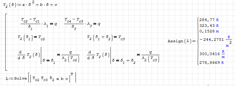

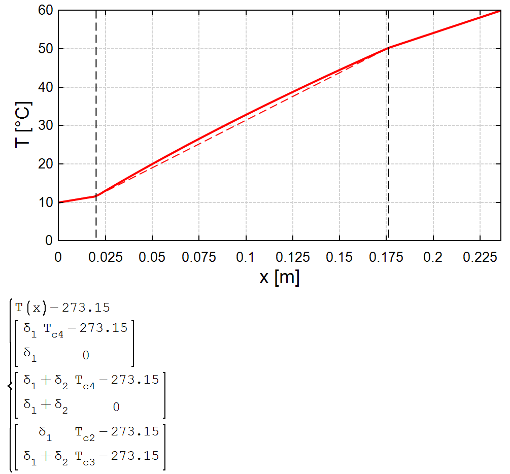

Don't know if that is the simplest solution.
Stenka-3-eng.sm (58,13 КиБ) скачан 1424 раз(а).
Valery Ochkov 15.07.2023 07:25:00

#6 Опубликовано: 15.07.2023 07:32:04
Version with mathcad block to collect the equations
Stenka-3-eng1.sm (59,5 КиБ) скачан 1443 раз(а).

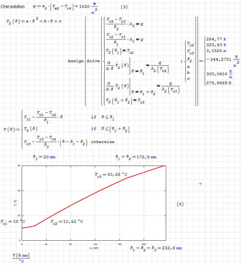

One solution from Alan Stevens
Stenka-3-Alan.sm (60,35 КиБ) скачан 1395 раз(а).
