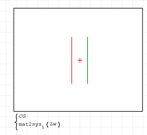

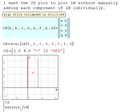

I am trying to create a sheet to design welds and want to plot the geometry of the weld lines.
the problem is if I assign a matrix with x,y coordinates the 2D plot will draw a continuous function connecting all points, and when I assign this to a discrete matrix of line coordinates it does not plot unless I assign each line individually which is bad as I want it plotted based on the geometry.
in the example below, I want the 2D plot to plot LW without manually adding each component of LW individually.
Thanks
#2 Опубликовано: 08.11.2022 15:18:08
Arie
Arie
One possible options mat2sys.1() function.
test_alyles.sm (35,91 КиБ) скачан 1308 раз(а).
... make it algo style. CG can be managed as well.
