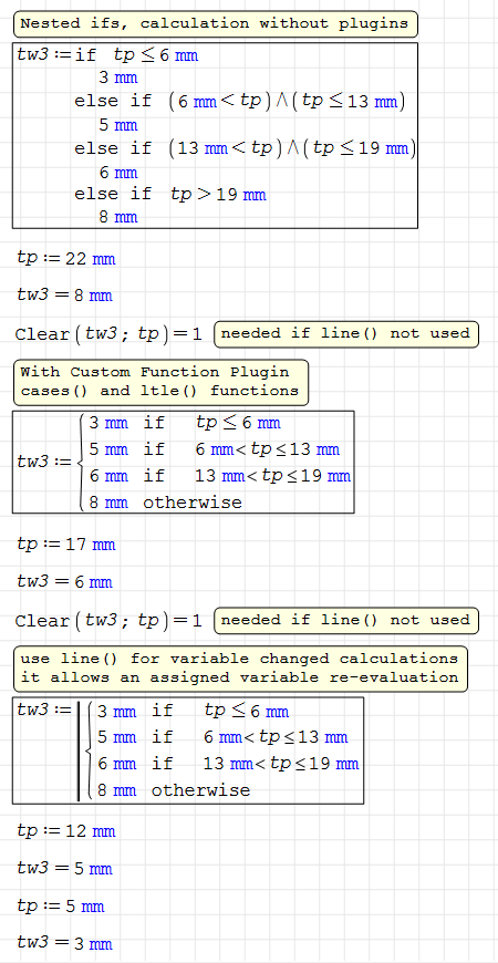

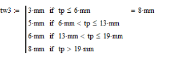

I am new user, need your help how to create this type of equations in Smath
#2 Опубликовано: 15.06.2023 07:36:01
if_function.sm (12,23 КиБ) скачан 1376 раз(а).

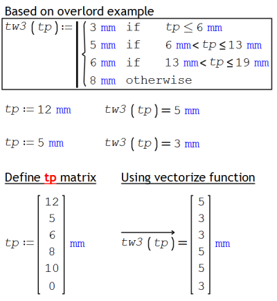

Based on program by overlord.
if_function_ndtma.sm (27,85 КиБ) скачан 1392 раз(а).

... from the drop down fx menu.
Making it a function as Amarasekera did is much more sensible solution.
