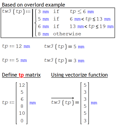

I am new user, need your help how to create this type of equations in Smath

Based on program by overlord.
if_function_ndtma.sm (27,85 КиБ) скачан 1095 раз(а).

Thanks all..
Very helpfull..

... from the drop down fx menu.
Making it a function as Amarasekera did is much more sensible solution.
