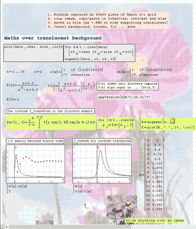

Like explained before, inserting background is translucent,
i.e: like if it was not here. Then immaterial wrt Smath stuff.
Please let us know if the attached has gray [228, 228, 175]
background ... did the transmission preserved the background ?
Inst_Z Transform.sm (90,39 КиБ) скачан 1633 раз(а).

I think you have to use an image manipulation program
like Gimp or Krita (both free).
In the example published by Jean, I copied the image to Gimp, lower the opacity to 38% and save the image in PNG format.
I have inserted the saved image as a background.
Inst_Z Transform_Jean.sm (2,97 МиБ) скачан 1788 раз(а).

Yes! I was looking at "muting" the background image as it was overwhelming the "calculation". IrfanView and OpenOffice call it "translucent" and you called it "opacity"
