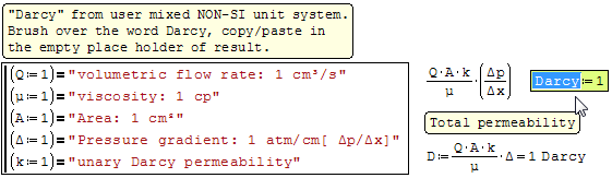

#2 Опубликовано: 24.10.2017 10:59:27
983 сообщений из 6866 понравились пользователям.
... many more Engineering don't come as easily as 2*3=6 m²
You don't have to freak Smath unit system, just like this:
... rather like this
