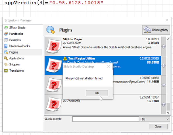

Unable to install Text Region Utilities plugin in 98.6128

Davide Carpi 12.10.2016 10:36:00
#2 Опубликовано: 12.10.2016 10:35:31
thank you, I'll fix it ASAP
#3 Опубликовано: 12.10.2016 11:39:21
Группа: Super Administrator
Davide, I've already fixed it by simple plug-in rebuild. Sorry, had no chance to inform you.
New version of the plug-in can be installed with no issues.

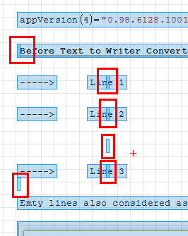

The "insert a toolbox" in Text Region Utilities Plug-in exibit erratic behaviour.
1. It shifts the selected text to a new position.
2. Apparantly, the empty lines between text lines are also considered as text?
3. Had to press "Apply" more than once to convert all selected text.

#6 Опубликовано: 13.10.2016 05:55:24
Thank you NDTM,
Fixing it, there were some changes in the API.
I'm not able to reproduce it; if you save the document with text regions and you load it again it still happens? If yes can you attach it here?

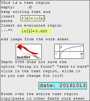

#7 Опубликовано: 13.10.2016 10:24:20
I don't understand what a "Tool Box" could be ?
Smath 5346 "Text Box" allows lot of decoration.
Decoration for a Web page presentation for instance.
As an Engineering working document: decoration is
too much, IMHO.
Each Shift/Enter adds blank line(s), an empty space
where to slide: images, graphs, foreign text ...

#9 Опубликовано: 13.10.2016 11:23:02
the problem still exists even after saving and re-opening.
Thank you, is exactly what I was thinking. If you select all (CTRL+A) you can see some empty text region, probably created with an UNDO action (because my bad coding in the converter feature). Should be no more an issue with the coming plugin update (but if existing you have to remove them manually).
