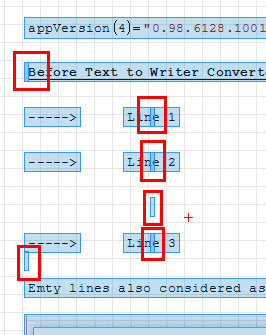

#5 Posted: 10/13/2016 12:45:45 AM
The "insert a toolbox" in Text Region Utilities Plug-in exibit erratic behaviour.
1. It shifts the selected text to a new position.
2. Apparantly, the empty lines between text lines are also considered as text?
3. Had to press "Apply" more than once to convert all selected text.
#6 Posted: 10/13/2016 5:55:24 AM
Thank you NDTM,
Fixing it, there were some changes in the API.
I'm not able to reproduce it; if you save the document with text regions and you load it again it still happens? If yes can you attach it here?
Wrote1. It shifts the selected text to a new position.
Wrote2. Apparantly, the empty lines between text lines are also considered as text?

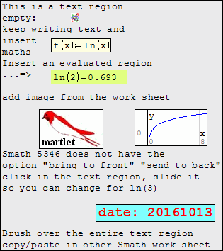

#7 Posted: 10/13/2016 10:24:20 AM
I don't understand what a "Tool Box" could be ?
Smath 5346 "Text Box" allows lot of decoration.
Decoration for a Web page presentation for instance.
As an Engineering working document: decoration is
too much, IMHO.
Each Shift/Enter adds blank line(s), an empty space
where to slide: images, graphs, foreign text ...
too much, IMHO.
#8 Posted: 10/13/2016 10:52:19 AM
Thank you Davide!
The original file is attached; the problem still exists even after saving and re-opening.
Before Text Converter.sm (73.44 KiB) downloaded 1321 time(s).
Davide Carpi 10/13/2016 11:11:00 AM
#9 Posted: 10/13/2016 11:23:02 AM
Wrotethe problem still exists even after saving and re-opening.
Thank you, is exactly what I was thinking. If you select all (CTRL+A) you can see some empty text region, probably created with an UNDO action (because my bad coding in the converter feature). Should be no more an issue with the coming plugin update (but if existing you have to remove them manually).
![2016-10-13 16_14_59-SMath Studio - [Before%20Text%20Converter.sm].png](/en-US/files/Download/aBNgcE/2016-10-13-16_14_59-SMath-Studio---[Before%20Text%20Converter.sm].png)
WroteI don't understand what a "Tool Box" could be?
Just a region that wraps some generic utilities related to the worksheet; when it will be possible I plan to move them in a toolbar (I'm working on it).

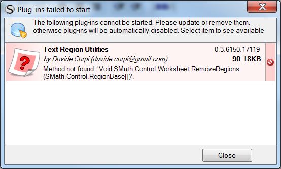

#12 Posted: 12/15/2016 2:43:38 PM
#13 Posted: 12/15/2016 3:22:31 PM
Thank you Alex,
recompiled, try now.
sergio 12/16/2016 3:41:00 PM
#14 Posted: 12/16/2016 3:34:02 PM
works fine now, thanks!
