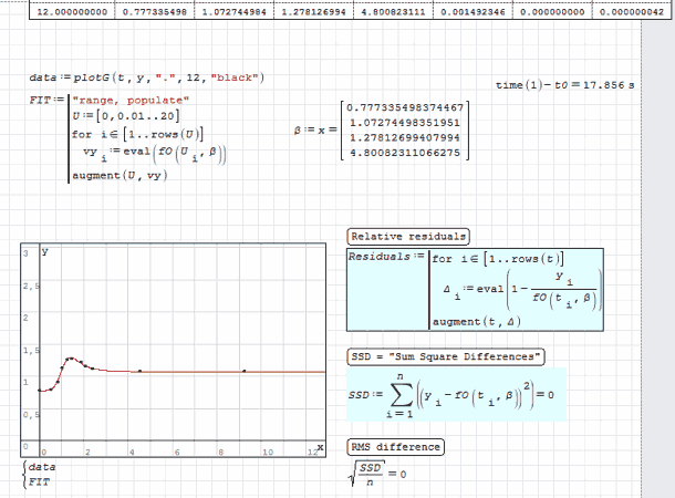

For this particular example, Carlos algorithm spits out in < hart beat !
Thanks again Carlos, it will surely help revamp some/many of the GenfitMinimize.
Levenberg_Marquardt_Code_CBG Copy.sm (65,28 КиБ) скачан 1344 раз(а).

#3 Опубликовано: 20.09.2018 11:23:37
Hello Jean,
The same example of the Levenberg Marquardt Algorithm, but obtaining
the Jacobian Matrix through finite differences
Thanks, Carlos: works fine.
More doctoring for you !
The work sheet "Otherwise" is only slightly otherwise for convenience, works fine.
The "Jacobian Fails" is another model attempted, Jacobian complains ... Ah !
Same model Pharmacokinetics works fine Conjugate gradient Minimize.
True: some model function can only be fitted by hand
True: GenfitMinimze may be difficult to initialize but work fine for my huge
collection [about 80 projects in Smath].
Levenberg_Marquardt_Code_CBG Model Otherwise Jacobian FAILS.sm (35,77 КиБ) скачан 1348 раз(а).
Genfit Pharmacokinetics.sm (43,67 КиБ) скачан 1288 раз(а).
Levenberg_Marquardt_Code_CBG Model Otherwise.sm (53,53 КиБ) скачан 1357 раз(а).

#6 Опубликовано: 21.09.2018 16:50:22
Hello Jean
Here is the L-M file that works with your example.
Thanks Carlos for doctoring.
By some regrouping, timing dropped from 3.8 min down to 2.6 min.
Niece Smath document for classroom and publishing.
Genfit Pharmacokinetics L-M Copy.sm (60,57 КиБ) скачан 1241 раз(а).

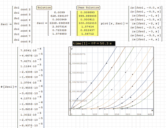

#7 Опубликовано: 26.09.2018 18:03:04
CBG
CBG
Hi Jean
Another example of the application of the Levenberg Marquardt algorithm,
this time with the Tesla function.
Levenberg_Marquard_Tesla_OK_CBG.sm (546,62 КиБ) скачан 1354 раз(а).
