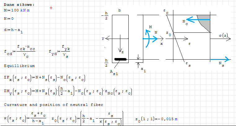

In my previous topic I was struggling with getting properly built equations.
Right now, I have prepared document, where I am looking for two unknows, basing on set of two equations. Can anyone take a look and help me to solve it? (attachment)

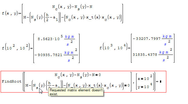

edit2: I have also prepared document without units (however that does not please me), but maybe it will be better to get some results. I have an answer 'requested matrix doesn't exist', while in Jean file message was: x - not defined. Please see attachment.
Strain_stress - SMath forum_mkraska usun jednostki.sm (78,88 КиБ) скачан 1204 раз(а).

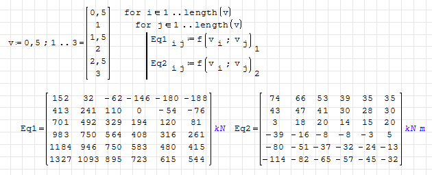

#5 Опубликовано: 07.03.2017 18:57:38
Bad chances for a solution
2017-03-07 22_55_15-SMath Studio 0.98.6179 - [Strain_stress%20-%20SMath%20forum_mkraska%20simplif.sm.png

Could you explain me what have you done in that "check" and what was you looking at?
I attach general rules of the method. Maybe I have some mistake hidden in equations? Solution should exist.
Strain_stress - SMath forum.pdf (522,3 КиБ) скачан 712 раз(а).

At this moment I want to solve equation, where I have given design moment (M) and axial force (N). The results I want to get are strains in both concrete and steel.
You are right that I am not calculating resisting moment right now.
The next step will be to get all possible moments (M) and forces (N), where strains are given to prepare so called interaction diagram N/M. Result below.
The formulea is true only when Eps.1>=Eps.yd=fyd/Es and Eps.2>=Eps.yd=fyd/Es - we can use M.Rd (6.30).
Otherwise then in equation we have to use correct value of stress σs=Eps*E.s and σc - then we may use the same formulea (6.30), but instead of fcd and fyd we will have fcd(eps.c) and fyd(eps.s).
I don't know if it is clear for you, if not please do not hesitate to ask.
I am still looking for solution of that problem.
