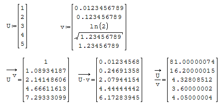

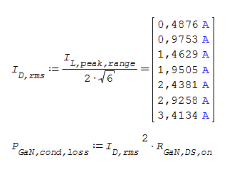

Is there a more convenient way of segment by segment multiplication of ranges than using a for cycle.
I am trying to solve the following:
(the problem is that all the data in the range should be segment by segment squared)
and also
Currently I have been able to solve the examples using a 'for' cycle:
But my question is: Is there a more convenient way to multiply, divide, square and root ranges segment by segment?
Thanks in advance!
Best regards,
Radko

Use vectorize from Matrix palette.

StoyanovR
StoyanovR
Thank you Radovan!
It saves a lot of time!
Have a nice day!
Radko
