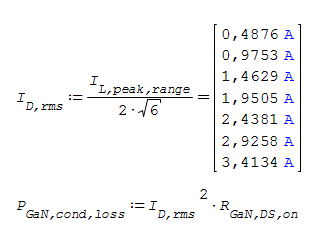

I am trying to solve the following:
(the problem is that all the data in the range should be segment by segment squared)
and also
Currently I have been able to solve the examples using a 'for' cycle:

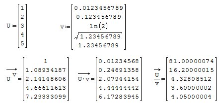

and also
But my question is: Is there a more convenient way to multiply, divide, square and root ranges segment by segment?

#3 Опубликовано: 10.02.2019 08:56:02
Thank you Radovan!
It saves a lot of time!
