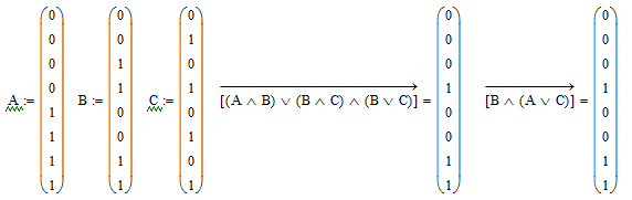

Unfortunately, as I am showing other students how to use logic, I wanted something simple for them to use. In Mathcad 15 it is easy to show an original expression, and alongside it a simplified expression resulting from using Boolean Algebra, and I was hoping that SMath Studio would do the same, as I do not expect my fellow students to pay for a copy of Mathcad. Unfortunately, SMath Studio does not have to option of a simple use for logic on vectors as does Mathcad 15 (see attached .jpg image from Mathcad 15 - I hope this works, as this is the first time I have tried to attach an image).
Once again, thanks for your assistance.
Eddie
