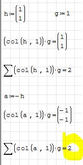

Could anyone look at this problem? The summation could not recognize the negative sign.
Please see the attached. Marked with yellow is not right.

This is again one of the weird SMath behavior regarding optimization.
Just right click on at least a:=-h region and turn on Numeric optimization
Thank you. It works turning on numeric
