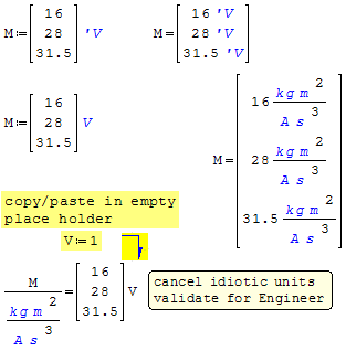

I read some post about units, but my problem occurs only for Vector / matrix.
If a declare a Matrix : P28V with three values (16V, 28V and 31.5V) and I want to display the result, the unit will be for each result : kg*m²/(A*s^3)
Are there some restriction about it?
For each Matrix that I used, I have to specify each time the unit (like V, mA) instead of the bigger one

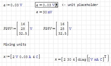

You can use the "unit placeholder" for display in the desired unit. Also can display several units for the same vector.

I understant I can change the unit manually to have the desired one.
But it not optimized especially for the vector, each time I have to changed the unit manually. If all the data on the vector have differents units, it take some times.
Have a nice day, Emilien
