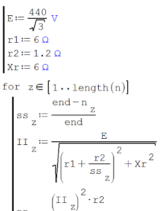

#5 Опубликовано: 10.04.2022 14:05:43
Fridel Selitsky
Fridel Selitsky
No function line()
Primer.sm (6,32 КиБ) скачан 1228 раз(а).

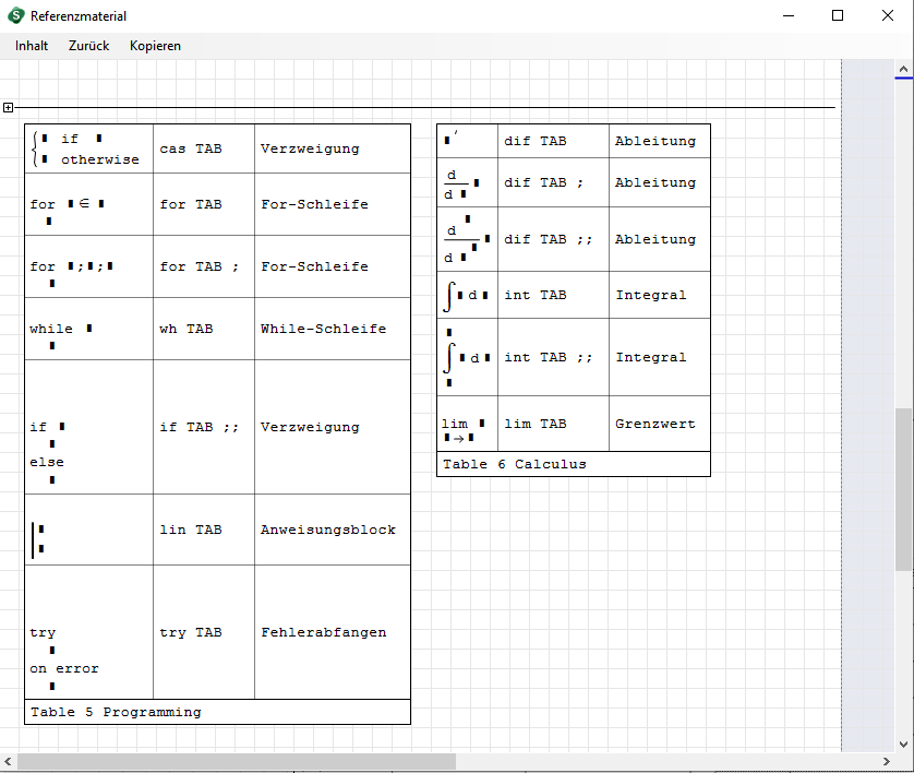

In Appendix B of the SMath Handbuch you find a list of operators and how to input them.
There is also a snippet "Help" in the online gallery but some entries there are not correctly formatted (problem with Table region).
In the interactive handbook you find these tables under >SMath Studio Documents >Operators and their keyboard input.
The tables there seem to be ok. There seem to be differences between the rendering engine in the reference material window and in the main window of SMath Studio.

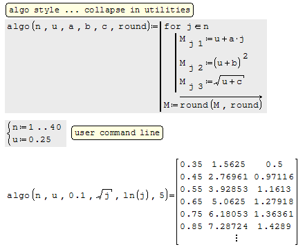

#8 Опубликовано: 11.04.2022 09:30:31
Your very first project may produce an arc region
as exemplified/demo in the attached ... NFG for suite.
As offered, no flaw ...
However, new command line dictates the suite be adapted.
Smath so gorgeous in there !
Cheers ... Jean.
Maths algo style.sm (43,74 КиБ) скачан 1212 раз(а).

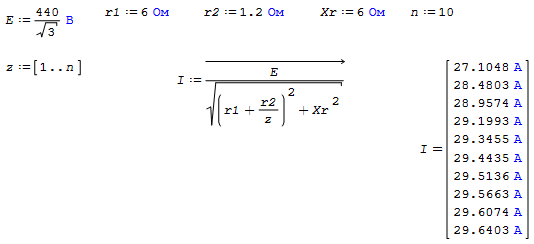

#9 Опубликовано: 11.04.2022 10:42:00
As I'm learning into SMath (and greatly enjoying this) I've struck a wee problem and I can't seem to find in the tool pallets or the interactive book/help videos.
Here, there is no tool palette.
Immensely productive.
... slightly refreshed.
Maths algo style.sm (46,74 КиБ) скачан 1232 раз(а).

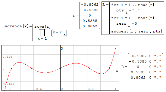

#12 Опубликовано: 12.04.2022 20:13:42
