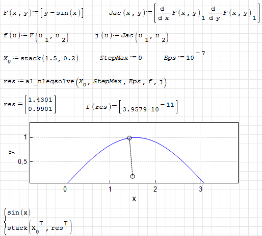

Underdetermined nonlinear system of equations.Three equations with four unknowns.
Visualization of finding the roots
Visual.sm (16,52 КиБ) скачан 1196 раз(а).

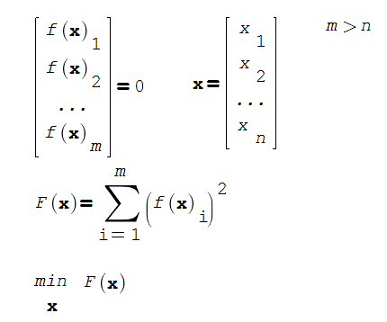

I hope you would not mind repeating myself. If you need to solve the system of m nonlinear equations in n unknowns (m>n) then you have to use some minimization procedure. This is a simple explanation of least square minimization.
One could see that if F(x) is quite close to zero, then all the f1(x), f2(x)... are also close to zero. This minimization procedure will also work with m=n, and then you will also have the solution of n equations with n unknowns as well.
I think that al_nleqsolve() can only solve the system where the number of equations is equal to the number of unknowns, which is not what you need.

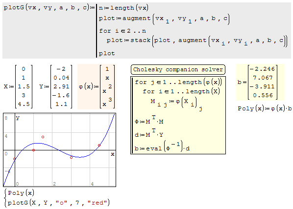

At this point, it is essential to learn about the extraordinary property of the Cholesky
solver, not new but so vividely visible in Smath.
It fits directly Lagrange polynomials on minimized SSD.
For more complicated models, in Smath, the refined fit is iterative Conjugate Gradient.
Please, take the time to read the minimalist introduction 7 documents.
Genfit Rational.sm (55,12 КиБ) скачан 1152 раз(а).
Polynomial fit Methods [linfitCheby].sm (42,97 КиБ) скачан 987 раз(а).
Genfit Rational Type J_8.sm (57,86 КиБ) скачан 1126 раз(а).
PolyFit QUICK.sm (24,91 КиБ) скачан 1165 раз(а).
Genfit Kirby_2 [Transmute].sm (41,22 КиБ) скачан 1007 раз(а).
Solve al_nleqsolve CSTR.sm (38,78 КиБ) скачан 1120 раз(а).
Polynomial fit Methods [ Rational linfit].sm (62,14 КиБ) скачан 1032 раз(а).

... revisit Cholesky SSD solver.
#112 Опубликовано: 17.07.2018 20:37:48
#113 Опубликовано: 18.07.2018 00:10:21
This version is an adaptive fit, worth the visit.
Polynomial fit_Cholesky.sm (47,84 КиБ) скачан 1154 раз(а).

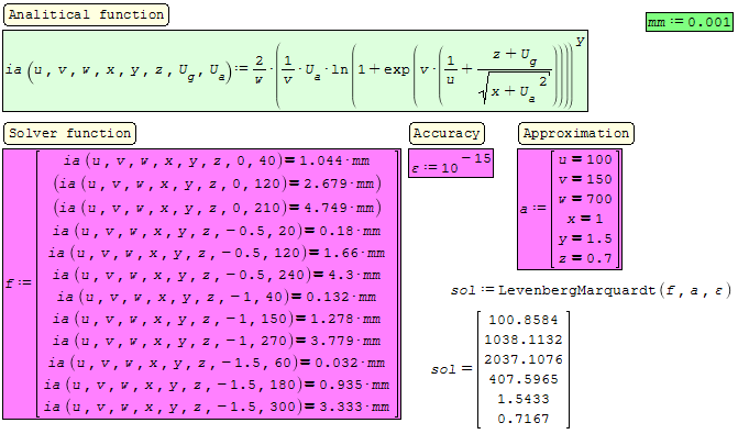

Hello.
I have insisted on the LM algorithm and I chose three points on each of the different curves represented by the vectors used as data. I wanted to see how far SMath could go by solving a system of nonlinear equations. I have arrived at the system in the image, taking the basis of the first four vectors, namely a1, b1, c1, d1. I have not tried other combinations, for example vectors a1, b1, c1, e1, etc. Under these circumstances, I can say that the results obtained are satisfactory to the good. Based on a 10-point rating system, I would write the result between 7 and 8. What first of all thanks me is that the algorithm could find this solution, starting from a sufficiently remote approximation. With the approximate solution in the picture, the calculation lasted about four and a half minutes. I still do not have the skill to use graphics. I would be glad if someone would recommend examples and tutorials in this regard. For the moment I made the graphical comparisons using the results obtained with SMath in MathCAD. Any equation added to the system in the image leads to errors, including system constraint. I'll continue the tests. Regards.
Nicolas.
LM1_.sm (13,14 КиБ) скачан 1159 раз(а).
#115 Опубликовано: 22.07.2018 23:26:16
The model function looks out the blue, at least can't be proved valid.
What do you get from Mathcad ?
If you get better sanity check from Mathcad, then Smath LM is under-designed.
LM1_.sm (35,31 КиБ) скачан 1188 раз(а).

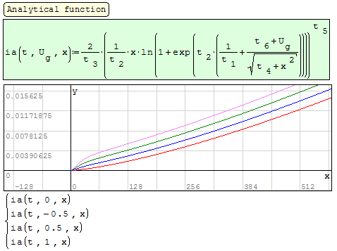

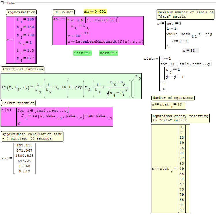

Hello.
I continued the tests and wanted to see how SMath could lead. I have tried to define the function in a recurring way, as in the attached picture. The first observation was (as in the other test) that for more distant values of the Ug parameter the algorithm gives errors. Then, although I was able to solve a system of 18 equations (even 19 in one of the attempts), the increase of the number over 20 is also accompanied by errors. A sign that the solution is close to reality is the value of the variable from the exponent, which is naturally very close to 1.5. I think the convergence criteria should be strengthened for the LM algorithm in SMath. Although I have succeeded in introducing several equations in the calculation, however, the result of the first test was better. This is because the equations in that case have been selected based on the results already known to me in MathCAD.
... If you get better sanity check from Mathcad, then Smath LM is under-designed.
I did not mean to say that. But just as for the Levenberg-Marquardt algorithm in SMath, there is still room for improvement.
A mathematical program should not only be considered for those with the highest mathematical skills. If you know how many engineers put on the scale just the empirical arguments revealed by the most palpable practice and run away when it comes to math! That's why I consider MathCAD an excellent program for wide categories of professionals. It's easy to drive even for the most inexperienced. I use the method of viewing on the graph rather for checking. I find it easier to compare two graphical curves than two inexpressive vectors. Therefore, being very little experienced in this regard regarding SMath, I preferred a check in MathCAD. Otherwise, all the best.
Nicolas.
LM1__.sm (44,6 КиБ) скачан 1143 раз(а).

ola_nicolas, I just slightly reduced the code of your program.
Nicolas.sm (12,06 КиБ) скачан 1189 раз(а).
#120 Опубликовано: 24.07.2018 13:38:41
Fridel Selitsky
Fridel Selitsky
However, AlgLib Solver works faster and depends little on X0 matrix.See # 29
https://en.smath.info/forum/yaf_topics32_Extensions.aspx
Overdetermined.sm (15,26 КиБ) скачан 1304 раз(а).
