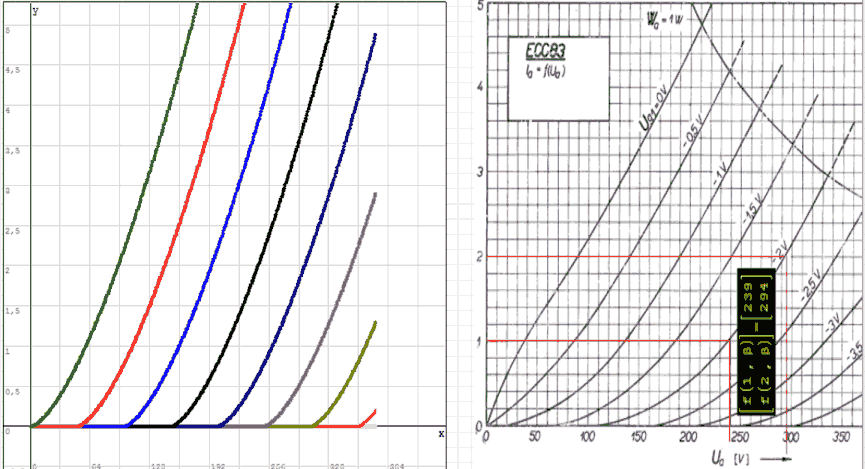

#27 Опубликовано: 07.06.2018 02:43:19
Thank you very much Jean for your accurate response.
Hello Carlos,
I read quick the paper. As it looks, the equation(s) apply to the
circuits with all resistances ... etc.
Some tips to optimize the project.
Nicolas should be happy ... are gone fishing ... how big the fish ?
A most interesting/educative project ... Thanks.
Tesla_CBG_R1 [optimized].sm (262,42 КиБ) скачан 1006 раз(а).

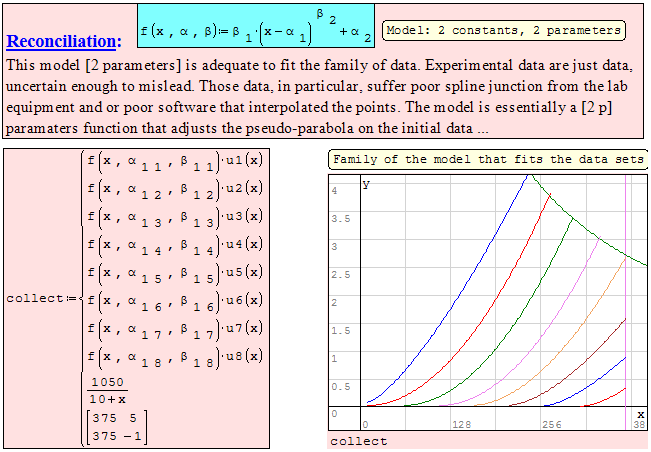

#34 Опубликовано: 11.06.2018 12:27:02
IMHO =
... this model should solve all curves.
It solves/iterates nicely for this particular data set.
f(x,β) recovers from the reduced solving procedure.
Genfit Minimze Tesla.sm (45,6 КиБ) скачан 1192 раз(а).

#37 Опубликовано: 13.06.2018 20:12:55
I'm just trying to do it. Otherwise today there are all kinds of complex electronic devices for automatic drawing of the curves characteristic of the triodes and the pentodes.
Ok ... Savant gadgets are just gadgets, proof: the one you have used has muffed
your lab test. L. Koren equation is phenomenological as it says. Unfortunately,
experimental data are not exactly reproducible. Nothing in the circuitry is
reproducible not even the triode/pentode ... think of similar physics wrt T/C
T/C = Thermocouples. In short, the Creator was short of fully understanding what
He was creating.
Your complex attempted formulation does not speak to me.
The attached proposal fits your data sets based on 2 parameters and 2 fixed constants.
The constants are the initials X, Y of each experiment. It needs only two parameters
for each experiment. The model function is not suitable for auto-iterate ... peanut
work to calculate trial/error.
If possible, it would be interesting your collect ~ 20 points, raw ... as measured
with good equipment. No processing, no spline curve junction.
Salut Nicolas, will read you soon ... Jean
Genfit Minimize Tesla(5) Copy.sm (207,62 КиБ) скачан 1224 раз(а).
#38 Опубликовано: 13.06.2018 21:32:28
... easy to trick the argument (x+ε)
Now, with a single set of initial β it iterates
and fits all data sets !
Genfit Minimize Tesla(5) Auto_Iterate.sm (211,37 КиБ) скачан 1232 раз(а).

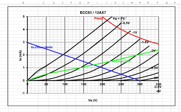

I found this page that I hope will be useful:
http://www.valvewizard.co.uk/links.html
It contains a file in excel for the calculation of the triodes graphs
LoadLinePlotter.xls (817 КиБ) скачан 746 раз(а).
