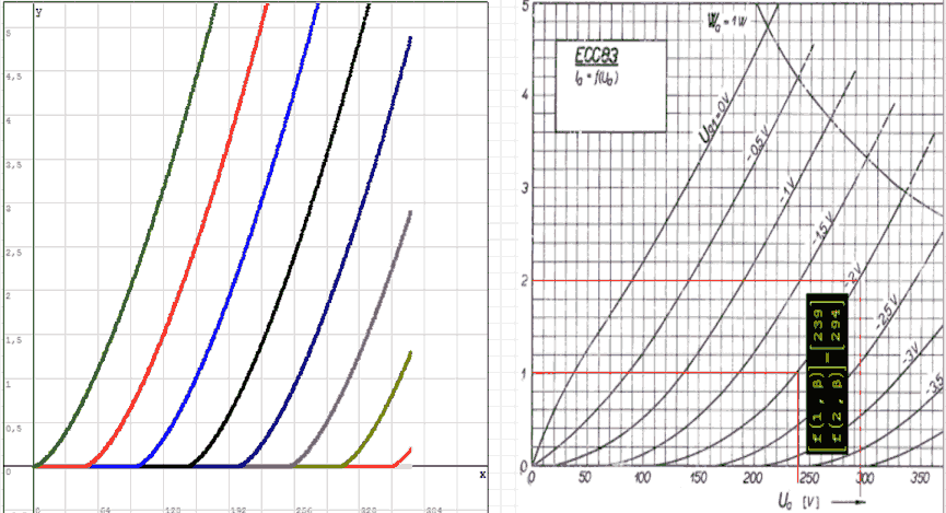

What I did, was simply find the equation that represents each curve
of the given graph. The functions are continuous, but when representing
a polynomial of 4 degree, they are unstable outside the specified ranges.
On the other hand, doing a little research, I found that the curves of
the TESLA graph were constructed with the equations of Scott Reynolds
and Marshall Leachfon, or with the improved equations of Normal L. Koren.

Here is a small attempt to graph the curves with the formulas indicated above.
Tesla_CBG_R1.sm (137.44 KiB) downloaded 1156 time(s).

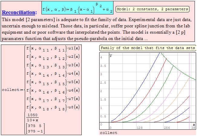

#34 Posted: 6/11/2018 12:27:02 PM
IMHO =
... this model should solve all curves.
It solves/iterates nicely for this particular data set.
f(x,β) recovers from the reduced solving procedure.
Genfit Minimze Tesla.sm (45.6 KiB) downloaded 1192 time(s).
#35 Posted: 6/12/2018 7:24:16 PM
From what I understood, the data sets are from unknown lab test.
Digitized from some simulation software or else valid method.
The project is collected and attached in "Samples"
If you have more questions, please do not hesitate.
High quality document for publishing.
Cheers Nicolas, be good ... Jean
Genfit Minimize Tesla (2) Copy.sm (213.89 KiB) downloaded 1141 time(s).

#37 Posted: 6/13/2018 8:12:55 PM
I'm just trying to do it. Otherwise today there are all kinds of complex electronic devices for automatic drawing of the curves characteristic of the triodes and the pentodes.
Ok ... Savant gadgets are just gadgets, proof: the one you have used has muffed
your lab test. L. Koren equation is phenomenological as it says. Unfortunately,
experimental data are not exactly reproducible. Nothing in the circuitry is
reproducible not even the triode/pentode ... think of similar physics wrt T/C
T/C = Thermocouples. In short, the Creator was short of fully understanding what
He was creating.
Your complex attempted formulation does not speak to me.
The attached proposal fits your data sets based on 2 parameters and 2 fixed constants.
The constants are the initials X, Y of each experiment. It needs only two parameters
for each experiment. The model function is not suitable for auto-iterate ... peanut
work to calculate trial/error.
If possible, it would be interesting your collect ~ 20 points, raw ... as measured
with good equipment. No processing, no spline curve junction.
Salut Nicolas, will read you soon ... Jean
Genfit Minimize Tesla(5) Copy.sm (207.62 KiB) downloaded 1224 time(s).
#38 Posted: 6/13/2018 9:32:28 PM
... easy to trick the argument (x+ε)
Now, with a single set of initial β it iterates
and fits all data sets !
Genfit Minimize Tesla(5) Auto_Iterate.sm (211.37 KiB) downloaded 1232 time(s).

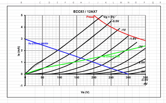

I found this page that I hope will be useful:
http://www.valvewizard.co.uk/links.html
It contains a file in excel for the calculation of the triodes graphs
LoadLinePlotter.xls (817 KiB) downloaded 746 time(s).
