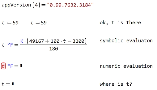

Hi- I've found an inconsistency when working with temperature units other than an absolute scale.
If I enter a number and multiply by either Fahrenheit or Celsius (°F or °C), the units are applied as I expect.
If I define a variable and assign a value to it, and then multiple by °F or °C, I get an error saying that the variable is not defined. It clearly is defined though, since performing other operations (multiplication, addition, assigning absolute scale temperature units, etc.) works as expected on the variable.
If I make a user-defined version of the temperature unit, assigning it to itself, and then apply the unit to the variable, it works okay.
Can anyone confirm this? I’m using the Mono version of release 7610 on Linux.

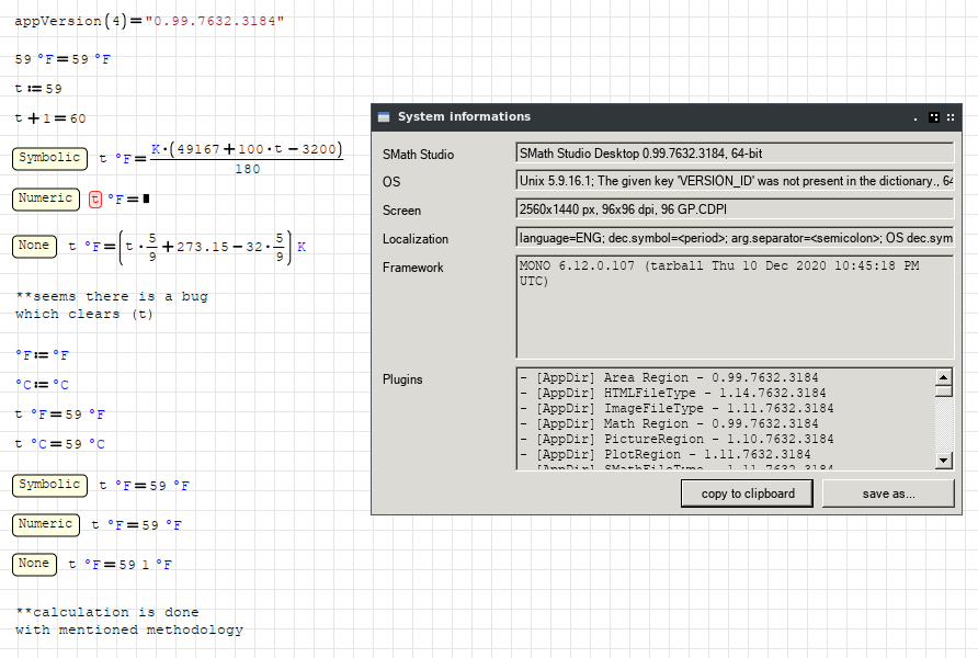

Hi. It seems that Fahrenheit degrees clears t.
Yep. On Windows 10.

Thanks very much for looking at that Alvaro. I had only tried numeric evaluation- I get the same result as you with symbolic evaluation.
It looks like you are in even worse shape than I am. The variable is still set to the original value for me after attempting to get a Fahrenheit value from it.
#6 Опубликовано: 27.12.2020 08:03:02
Same in here with Mono.
