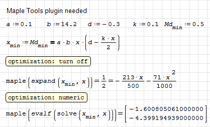

Good morning, I'm new to Smath Studio, I would like to know if it is possible to obtain the same result that was obtained in mathcad prime 6.0
https://i.ibb.co/S76VZZY/mathcad.png

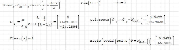

can you show me how to get these results?
EQUACAO DO 2deg GRAU.sm (10,03 КиБ) скачан 1208 раз(а).
https://sendgb.com/q9R6s4jKJuo
WroteWrotecan you show me how to get these results?
Maybe from the Smath document if you attach.
Wrotenot the end result but what is between expand and solve
If this is your doctrine ... superb !
There is an Smath document that constructs polyroots.
WroteWrotenot the end result but what is between expand and solve

I need the blue rectangle to be the same as the yellow one, is this possible?
https://ibb.co/2n6Np5C
WroteWroteWrotei need to show the students step by step how to perform the calculations
What construction/calculation step by step ?
Not possible to easily write all those functions in one line.
It can be done with serious alterations but shall not be practical.
I posted something similar to another user. But again, I wouldn't use it.
Just write functions and solves in multiple lines.
