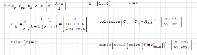

Good morning, I'm new to Smath Studio, I would like to know if it is possible to obtain the same result that was obtained in mathcad prime 6.0
math cad prime 6.0
https://i.ibb.co/S76VZZY/mathcad.png

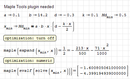

Hi Tiago. This is one way.

I need this display after the expand
https://ibb.co/Sfmj1jz

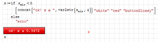

I need the blue rectangle to be the same as the yellow one, is this possible?
https://ibb.co/2n6Np5C

not the end result but what is between expand and solve
#10 Опубликовано: 09.12.2021 17:45:02
The polynomial coefficients?

sorry for my ignorance i didn't understand your answers, and because i need to show the students step by step how to perform the calculations
#14 Опубликовано: 10.12.2021 08:22:24
What construction/calculation step by step ?
Not possible to easily write all those functions in one line.
It can be done with serious alterations but shall not be practical.
I posted something similar to another user. But again, I wouldn't use it.
Just write functions and solves in multiple lines.
