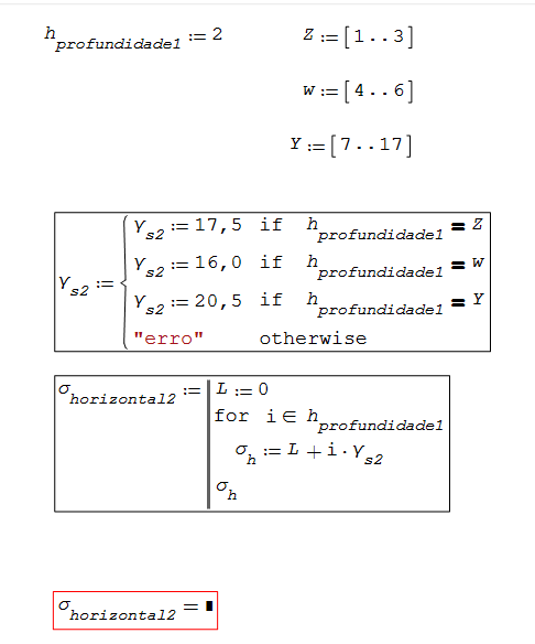

Good afternoon, could someone explain to me how to solve this problem I need that the horizontal voltage varies according to the depth however and the s2 gamma.
my input data is hprofundidade1 z w and y
TESTE TENSAO ADM MATRIZ.sm (5,41 КиБ) скачан 1245 раз(а).

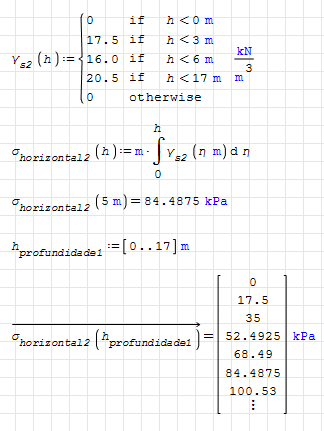

#2 Опубликовано: 06.01.2022 01:50:51

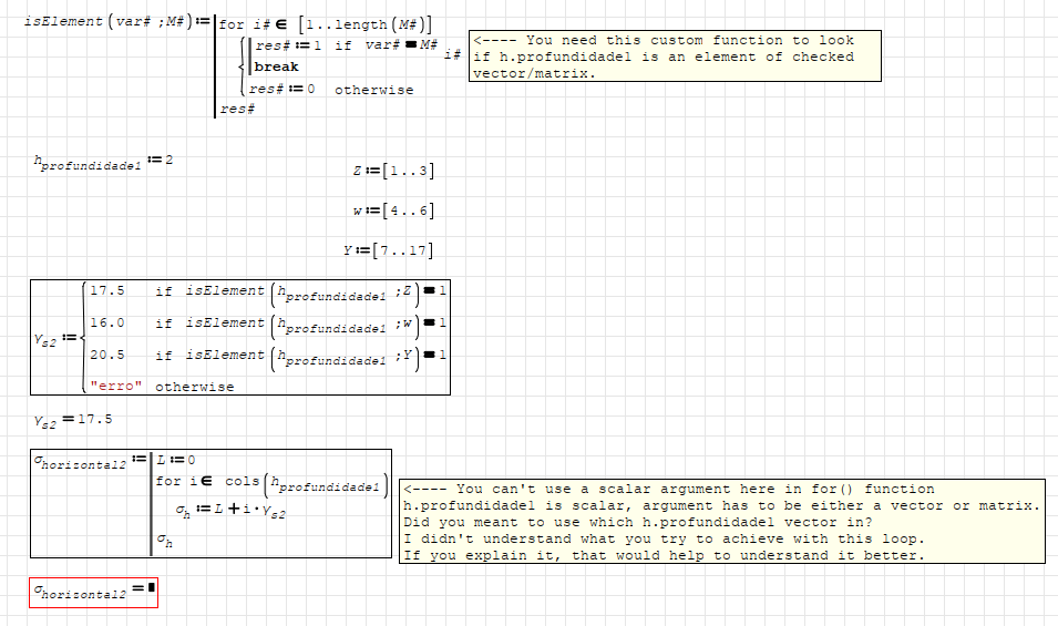

I didn't understand what to calculate in sigma function.
A little more explanation would help to resolve it.
TESTE TENSAO ADM MATRIZ_r1.sm (8,44 КиБ) скачан 1278 раз(а).

I still don't understand purpose of for() loops. (not in your solution, original question)
Removing for()'s and calculating directly won't change the result.

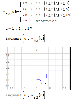

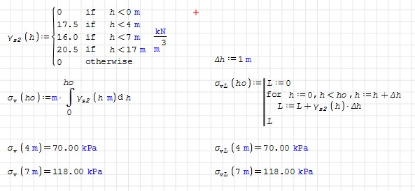

Hi overlord. I guess because using γ.s2(h)*h isn't correct, there the correct acumulation is γ.s2(h)*Δh
TESTE TENSAO ADM MATRIZ.sm (10,8 КиБ) скачан 1227 раз(а).

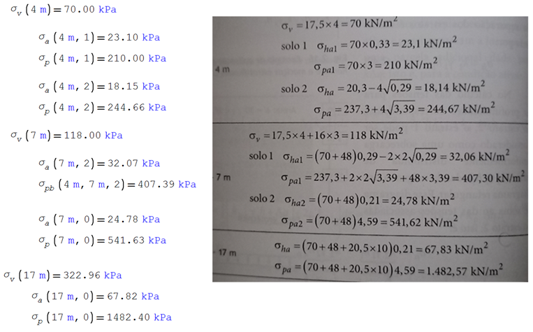

thank you all for making your time available, helping me with this problem but some of the solutions posted here do not match the values must be equal to sigma,v in the image or 70 kN/m2 at 4m depth and 118 kN/m2 at 7m depth.
see the resolution of the problem in the attached image

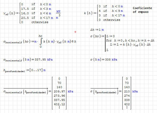

At this point, up to You to handle the project.
I understood nothing in that big image.
TESTE TENSAO ADM MATRIZ (in_situ parametric).sm (18,6 КиБ) скачан 1303 раз(а).
This is a way to do that in SMath.
TESTE TENSAO ADM MATRIZ v2.sm (455,7 КиБ) скачан 1366 раз(а).
