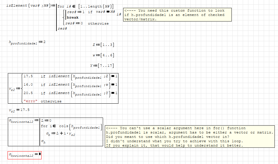

Good afternoon, could someone explain to me how to solve this problem I need that the horizontal voltage varies according to the depth however and the s2 gamma.
my input data is hprofundidade1 z w and y
TESTE TENSAO ADM MATRIZ.sm (5,41 КиБ) скачан 1204 раз(а).
WroteGood afternoon, could someone explain to me how to solve this problem I need that the horizontal voltage varies according to the depth however and the s2 gamma.
I didn't understand what to calculate in sigma function.
A little more explanation would help to resolve it.
TESTE TENSAO ADM MATRIZ_r1.sm (8,44 КиБ) скачан 1222 раз(а).
WroteWroteGood afternoon, could someone explain to me how to solve this problem I need that the horizontal voltage varies according to the depth however and the s2 gamma.
I don't understand the problem, only to get a plot.

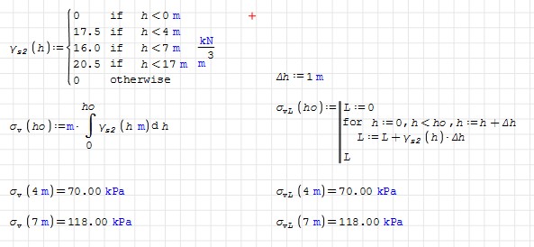

Hi. I think that this could be the solution.
TESTE TENSAO ADM MATRIZ.sm (5,88 КиБ) скачан 1208 раз(а).
WroteHi. I think that this could be the solution.
I still don't understand purpose of for() loops. (not in your solution, original question)
Removing for()'s and calculating directly won't change the result.

Hi overlord. I guess because using γ.s2(h)*h isn't correct, there the correct acumulation is γ.s2(h)*Δh
TESTE TENSAO ADM MATRIZ.sm (10,8 КиБ) скачан 1183 раз(а).
WroteWrotethank you all for making your time available, helping me with this problem but some of the solutions posted here do not match the values must be equal to sigma,v in the image or 70 kN/m2 at 4m depth and 118 kN/m2 at 7m depth.

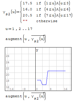

Cleaned image(s) for publishing the traced reference.
You can have as many sets of parameters [p,d] as you wish,
even of different length as long as you update respectively.
Cheers ... Jean.

I guess the last 4 'x' points [18,19,20,21] should be removed.
