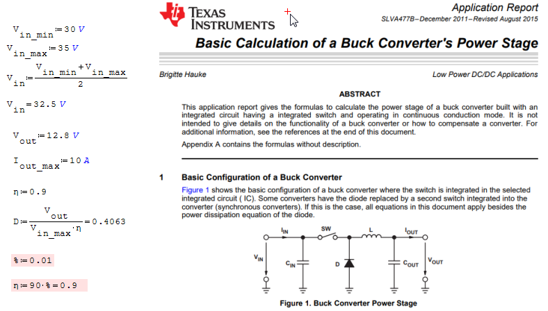

The attached sMath file is an attempt to add "current page" background images. One image per page. It work find for the first two pages, but the third one get skipped and the image appeared on the fourth page.
dc dc buck converter.sm (735,13 КиБ) скачан 1385 раз(а).
Basic Calculation of a Buck Converter Power Stage.pdf (202,96 КиБ) скачан 1100 раз(а).
The goal here is to study technical document by overlaying sMath formula, graph and other elements on top of the background images.
Also attached, the original PDF file and the png images for each pages.
Also, it is not obvious how to remove background images, either "All" or "Current page". I couldn't remove the ones in the attached sMath file.
Thank you for your help
Guy

Oups, I didn't know that the images would appear full size. I am sorry, but I dont know how to to it otherwise.
I did not know that several background images can be inserted. Actually, I do not know how to do it either. But as workaround you can edit the sm file for correct the position of the image on page 3.

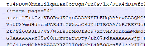

frapuano 14.09.2018 10:33:00
Thank you for this way around. First time I venture into a sm file. I will give it a try.
As for how to do it, just select "Background..." in the "Insert" menu. You will see the background setting window.
As I mention in the post, part of that UI is not obvious. It is hard to tell if you have already selected a "Current page" background. Also the default setting seem to reset itself each time you quit the window. The expected behavior would be to reflect the setting of the current page or the whole document.
Editing the file worked first try. That is great :-) The sm format is pretty simple, nice to see that.

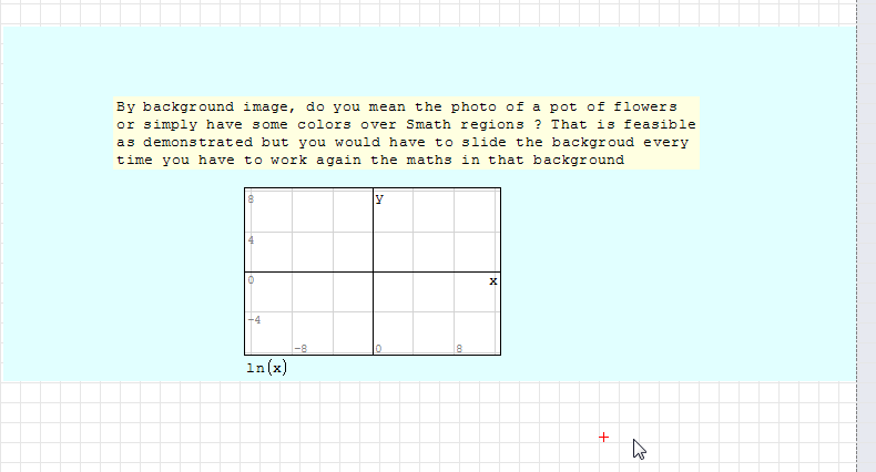

This peanut demo is 2.65 kB. You can have as many regions as you wish,
of any colors out of 1677216 possible colors. The background is OK
by the Print Preview, thus will be saved on virtual *.PDF printer.
This background region is not an imported image, neither an image
created by Smath. Thus, every time you save and at the opening of
the document, Smath complains it can find ... because it is not
really created ... just an incomplete fake. So, on the complain
just click OK to stop Smath suffering.
