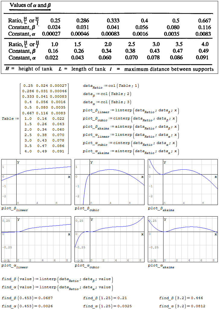

The aim is to obtain alpha and beta values from any intermediary values of H/L or H/l.
Thanks,
There are three different interpolation functions.
Your data seems to be lineear according to values.
Here is a demonstration of interpolation plots.
I also added functions to find β and α.
interpolation.sm (138,91 КиБ) скачан 1276 раз(а).

WroteYou can use interpolation functions for that.
Your data seems to be linear according to values.
Thank you, Overlord. Much appreciated.
Tim
