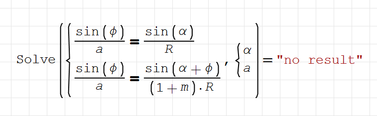

Thanks Jean,
Both a and alpha are unknows.
the result of a and alpha are still includes these unknows.
Only φ, R and m are knowns and can be used in the results.

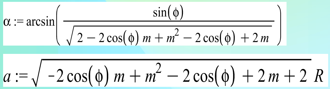

Thanks Jean,
Buy you 2nd sybolic solution is the same as the 1st one.
The solution should not include the unknow a and alpha
My friend use Maple to get symbolic solution like this
You can see that in the solution of alpha, there is no a, in the solution of a, there is no alpha.

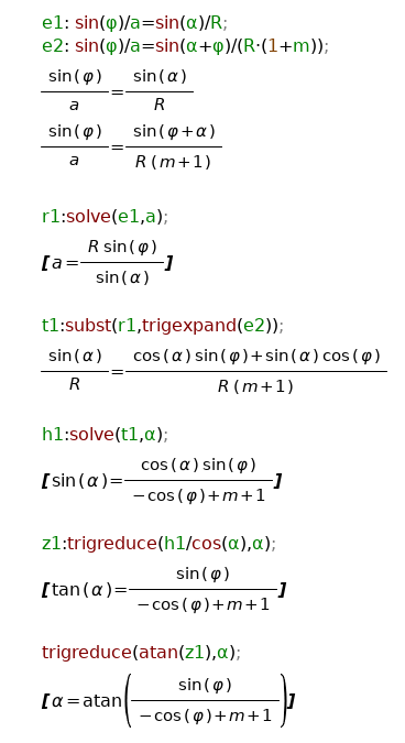

Here is α solved symbolically in wxMaxima.
Same method can be applicable for variable a.
untitled.wxmx.zip (1,6 КиБ) скачан 377 раз(а).

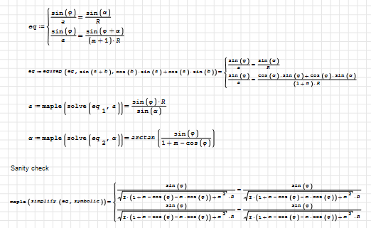

#7 Опубликовано: 22.02.2022 11:55:34
Is Maple plugin in Smath able to get symbolic results as Maxima does, but more easily?
Maple is easier to use, that is a fact.
And sometimes it gives better results.
But Maxima can surpass Maple at certain aspects.
Use what suits your needs most.
In the example below, I solved your function with Maple.
Though it gives the results correct, result matrix is cripled.
Copying and changing last bits of result ";2;1)" to ";2;2)" will correct the result.
";" may differ to "," according to your arguments separator.
Worksheet1.sm (15,97 КиБ) скачан 1291 раз(а).

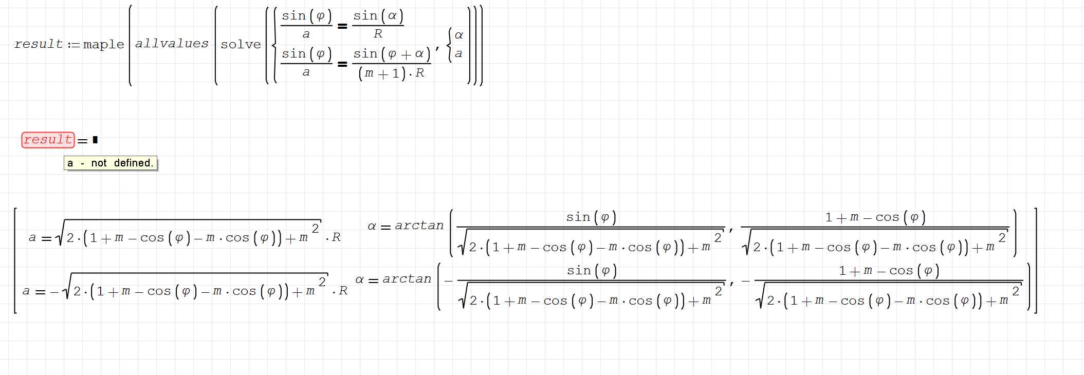

#10 Опубликовано: 16.04.2022 12:26:22
churichuro
churichuro
29 сообщений из 79 понравились пользователям.
Hi overload,
When I open you sm I get this error
appears in red, because the evaluation must be symbolic.
select the "result" variable, press the right button and in the type of evaluation select symbolic and that's it.
I hope I have served you, greetings

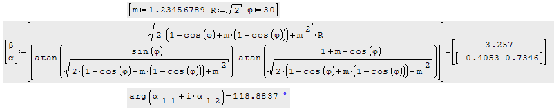

#11 Опубликовано: 16.04.2022 12:43:00
Hi. Another way, applying trigonometric identities.
solve_trig.sm (12,03 КиБ) скачан 1235 раз(а).
Addition to churichuro's reply, use this simple function to correct maple plugin result matrices.
maplecorrect.sm (26,79 КиБ) скачан 1835 раз(а).
