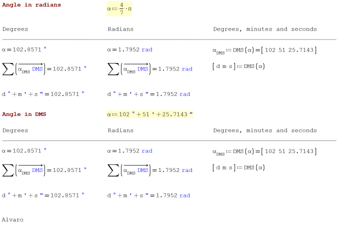

Hi. Here, my workaround.
DMS.sm (17,67 КиБ) скачан 1239 раз(а).
frapuano 23.02.2019 12:28:00, sergio 23.02.2019 18:26:00

#8 Опубликовано: 23.02.2019 14:06:06
Hmmm... The separate units use is interesting. I am so inexperienced with SMath I can't figure out how to enter the summation portion.
Hi. Try this as general rule for SMath sintaxis:

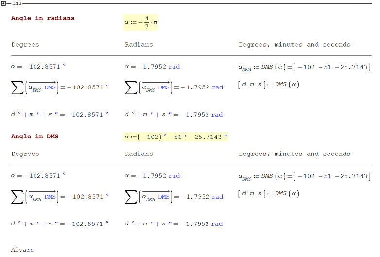

I think I will need to leave the negative angle input as [ -d -m -s ] with this approach. Would you agree?
Guess yes:
