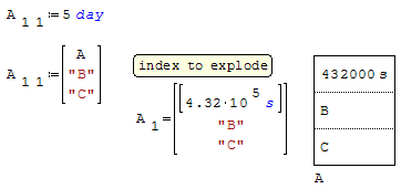

Smath Studio fails when a table containing arrays is inserted, and closes unexpectedly.
Test_Table.sm (6,37 КиБ) скачан 1267 раз(а).

may be this helps better to understand the situation here.
correction: force close occurs if the first element of matrix is a string.
table_test2.sm (23,06 КиБ) скачан 1390 раз(а).

Here is the latest deal, I have created a portable 6606 version which has no extension plugin except table region.
Now the table plugin is working as it should be. Maybe one of the installed plugins is creating the havoc.
I am going to try to find it by installing one at a time.

#12 Опубликовано: 06.02.2018 17:56:29
601 сообщений из 1 382 понравились пользователям.
Andrey,
Could you please change your decimal symbol from comma to period and try to open the test file above?
I think I have found the culprit. When I change it to comma, no issues so far.
Andrey Ivashov 06.02.2018 18:05:00
#13 Опубликовано: 06.02.2018 18:04:55
Группа: Super Administrator
Thank you very much! I will check decimal symbol and will try to fix the plugin asap.
#14 Опубликовано: 06.02.2018 19:21:15
Issue is reproduced. Working to investigate and fix.
#15 Опубликовано: 06.02.2018 20:16:31
Please could you try to update plug-in and test your examples?
I think I have fixed the issue.
CBG 06.02.2018 20:42:00, Davide Carpi 07.02.2018 04:10:00
#16 Опубликовано: 06.02.2018 20:21:20
Table region is not causing force crash.
Everything seems good, congrats.
Andrey Ivashov 06.02.2018 20:22:00, CBG 06.02.2018 20:42:00
#17 Опубликовано: 06.02.2018 20:41:25
CBG
CBG
Now the example works very well.
Thank you very much.
