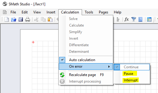

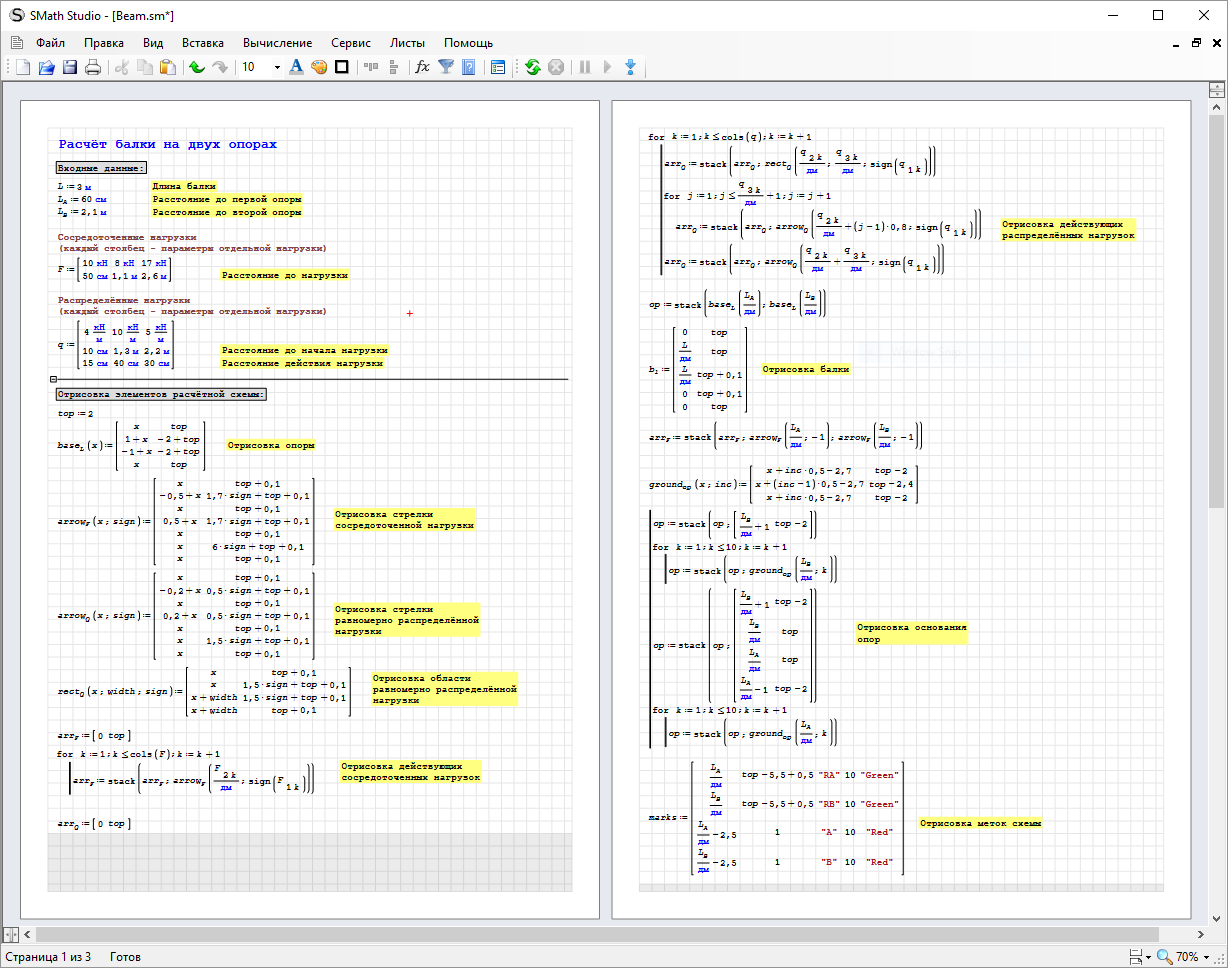

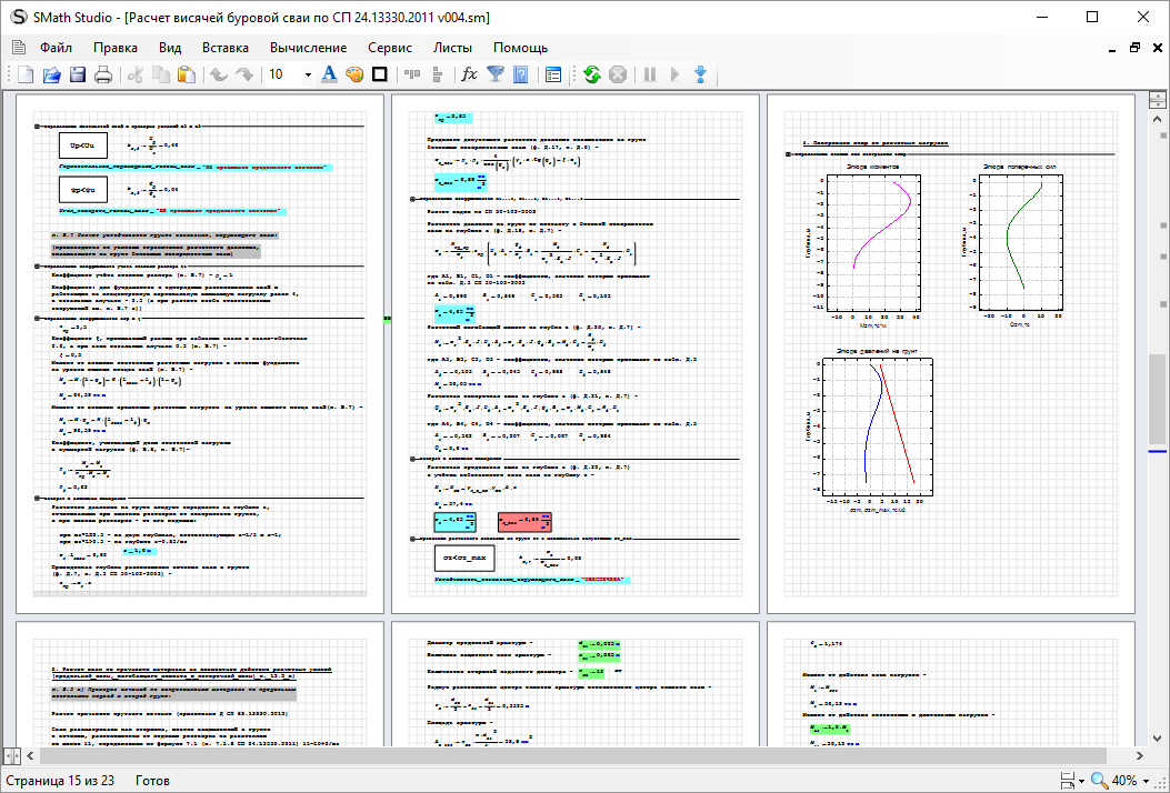

  • Added possibility to display multiple pages side by side if there is enough horizontal space on the screen (in order to control this feature Multiple Pages menu item added to the View menu);
  • Added ability to specify behavior on calculation error occurs: Continue (default), Pause or Interrupt;
  • Added ability to change math variable by pasting text from Clipboard.

BTW: Interrupt on error is very handy - allows to break further Worksheet calculation if anything goes wrong. May really simplify work with large documents.
Use Ctrl+Mouse Wheel to play with Multiple Pages feature.
