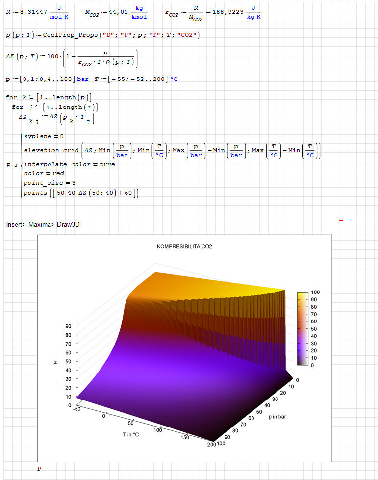

Hi, i would like to add some points to 3D plot. How can I do that?
And can i somehow make the plot smooth without using smaller steps in vectors?
Kompresibilita_3D.sm (56,04 КиБ) скачан 807 раз(а).
Thanks for answers,
Tomas

You could try to create a mesh of triangles or quadrilateral objects. Then you are free to use a problem-adjusted surface parametrization.

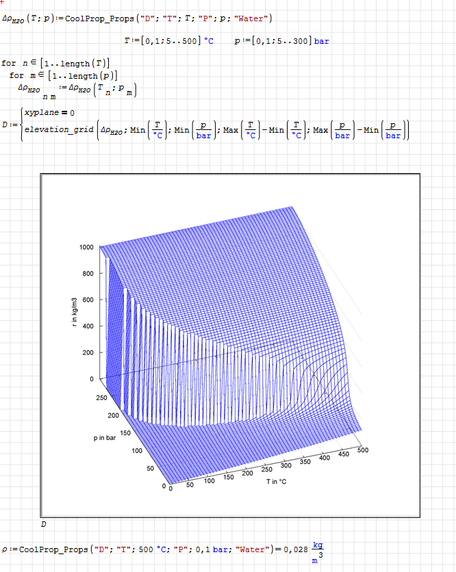

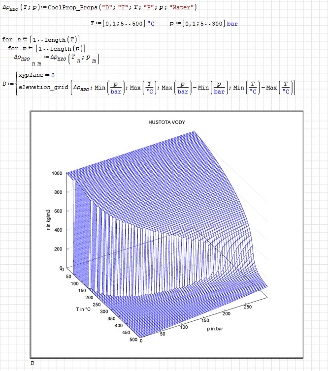

thanks for your answer. I have another question. I´m trying to make graph of water density, but the axes are not right, what is wrong?
hustota vody.sm (69 КиБ) скачан 707 раз(а).

Thanks you very much! That helped.
But if i want to make axes right i have to switch x and y axes in elevation grid command. I don’t know why.
hustota vody.sm (135,01 КиБ) скачан 714 раз(а).

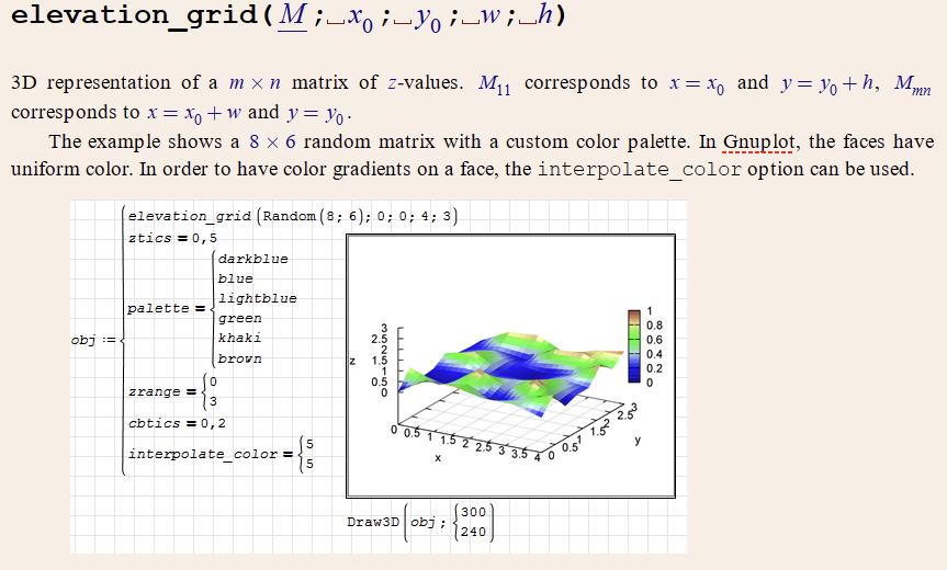

Is there any sheet of something like that, where I can fing all comands for plots? And how can I write them, because commands that I used, I copied from some file I found.

See topic starter https://smath.com/en-US/forum/topic/cnc5Xp/Maxima-Plugin. I added some references there.

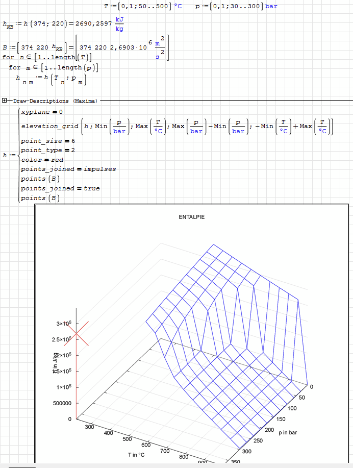

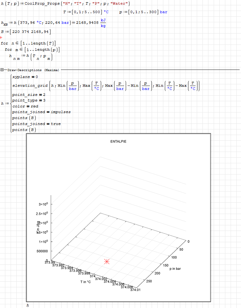

how can I add point B to plot? When I tried I make point or plot, but not both of them.
kriticky_bod.sm (202,22 КиБ) скачан 717 раз(а).
Thanks for answers,
Tomas
Thanks for answers,
Tomas
Thanks for answer,
I tried to fix it and I ended with this. Still can t plot graph and point together.
kriticky_bod.sm (201,86 КиБ) скачан 682 раз(а).
What should I do now?
Tomáš
Tomáš
You still have a negative h value (temperature difference). Reverse this (and also reverse the matrix). Then it should work.

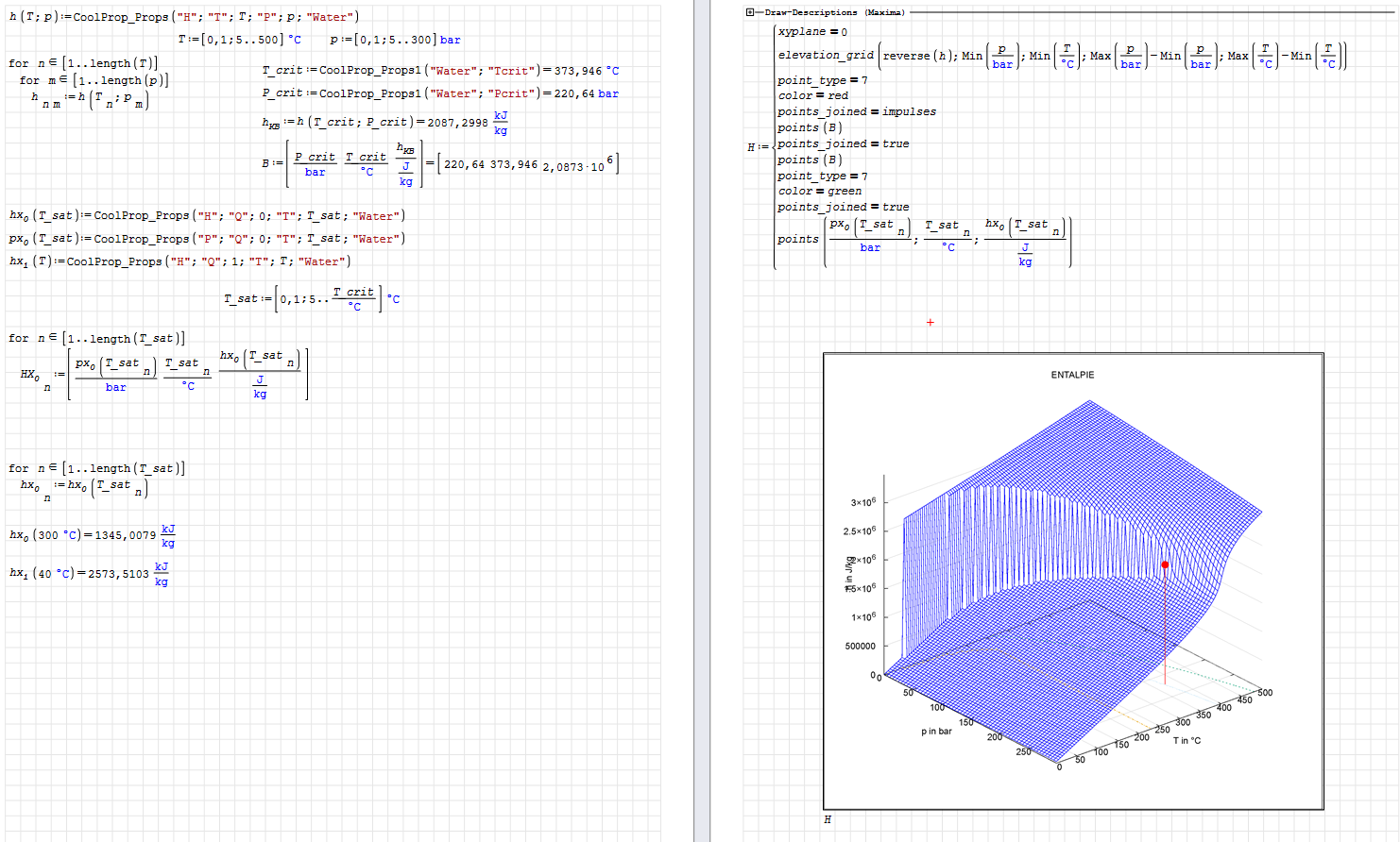

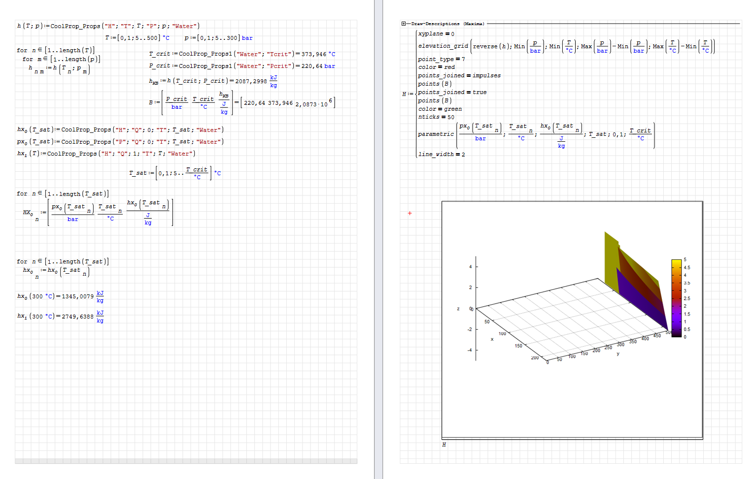

Now I would like to add saturation curve. Is it better to go with matrix or function? And how can I do that?
I tried parametric function, but plot did not work.
krit_bod_2.sm (211,84 КиБ) скачан 681 раз(а).

I guess it is best to use the points object just like for the single point. Set points_joined to true, point_type to something convenient. Using a function will work only if that function is supported by the interface to Maxima, which probably doesn't apply to coolprop functions or interpolated functions.

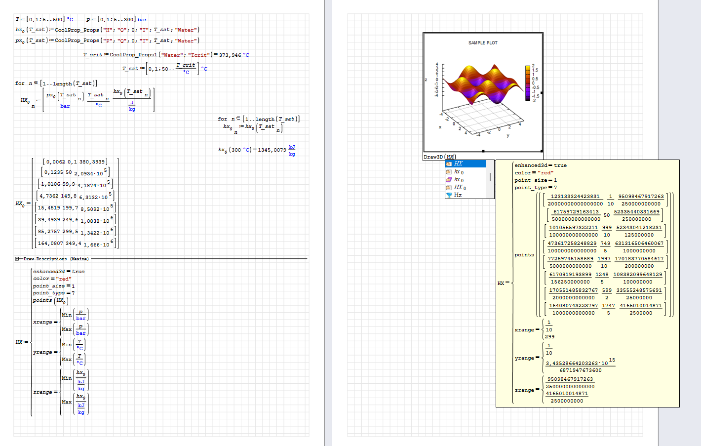

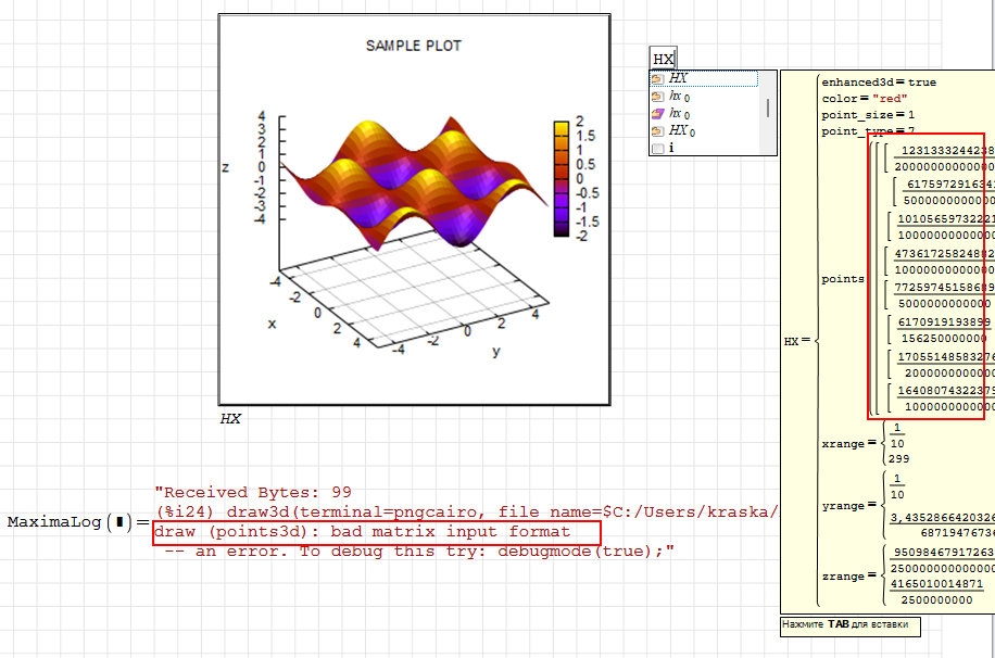

I’m back. I tried to create line of points by maxima handbook. Handbook is really great, but I couldn’t figure it out. What am I doing wrong? Matrix seems right.

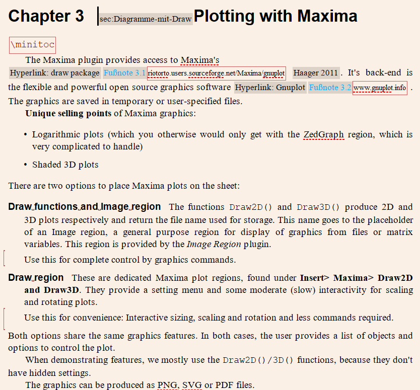

And i have another question. When I created plot of enthalpy I just wrote name of the "plot function". But in the manual, there is Draw3D("plot function"). Why is that?
saturation_curve.sm (194,75 КиБ) скачан 629 раз(а).

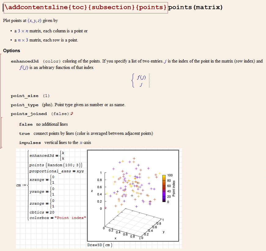

Your data matrix isn't in the correct format. It is a one-column matrix of row vectors. Make it a real n x 3 matrix, then try again.
Also, you use different units when filling the data matrix (J/kg) and for the axis limits (kJ/kg).
As to the Draw3D command, see intro text to Chapter 3.

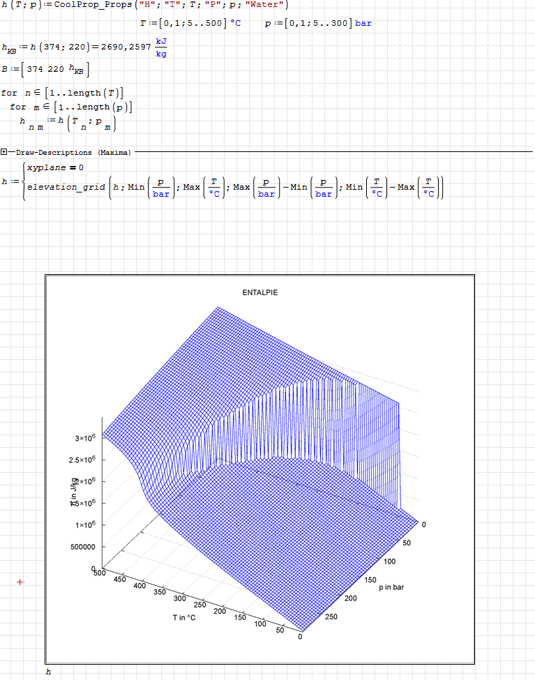

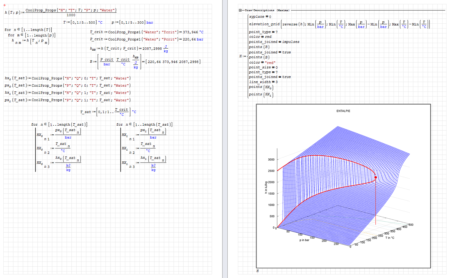

finally I’v done it! Thank you very much Martin! I think it looks great.
Now I would like to continue and mabye try to make something bigger and try to use Smath viewer.
Entalpie_pT.sm (156,56 КиБ) скачан 604 раз(а).
Tomáš
Tomáš
