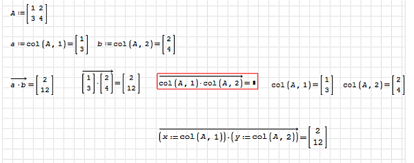

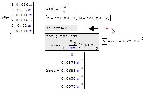

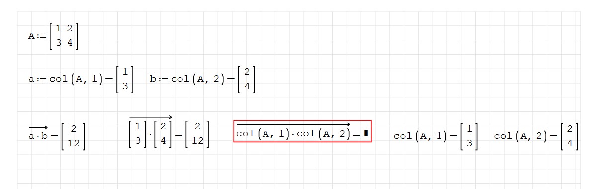

I am having this issue evaluating the vectorized multiplication:
I don't know what the problem could be. I started today switching definitely from Mathcad Prime 5 and started rewriting some codes.
Really happy with the decision I made, and also with the latest SMath studio version, I am running 0.99.7251 SMath.
Thank you in advance for your help,

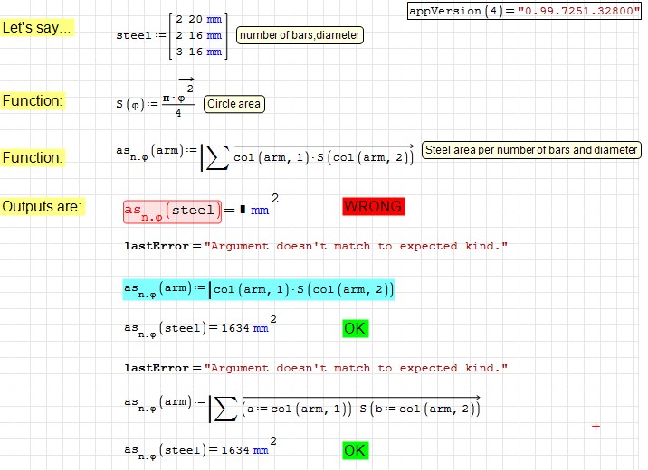

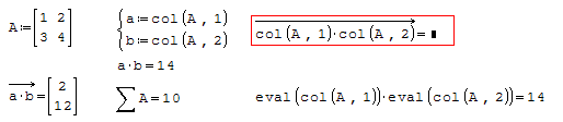

Matrices are multiplied like in a matcade
#3 Опубликовано: 16.04.2020 11:23:24
Just a matter of isolating the code
col(A,1), col(A,2) are not like function.
#4 Опубликовано: 16.04.2020 15:52:44
NDTM Amarasekera
NDTM Amarasekera
This way it works.

Thank you all for your quick responses! Problem solved with ndtma solution. Thank you

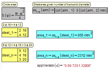

#10 Опубликовано: 24.04.2020 22:45:36
Alvaro Gavilán-Rojas
26 сообщений из 68 понравились пользователям.
Thank you Jean for your suggestion.
I would rather use a function, because in various parts of my worksheet (beam design), I need that function. It would be like this:
AG24042020-Steel area.sm (6,48 КиБ) скачан 1510 раз(а).
#11 Опубликовано: 25.04.2020 16:45:24
Maybe like this.
Project SteelBar.sm (23,19 КиБ) скачан 1565 раз(а).

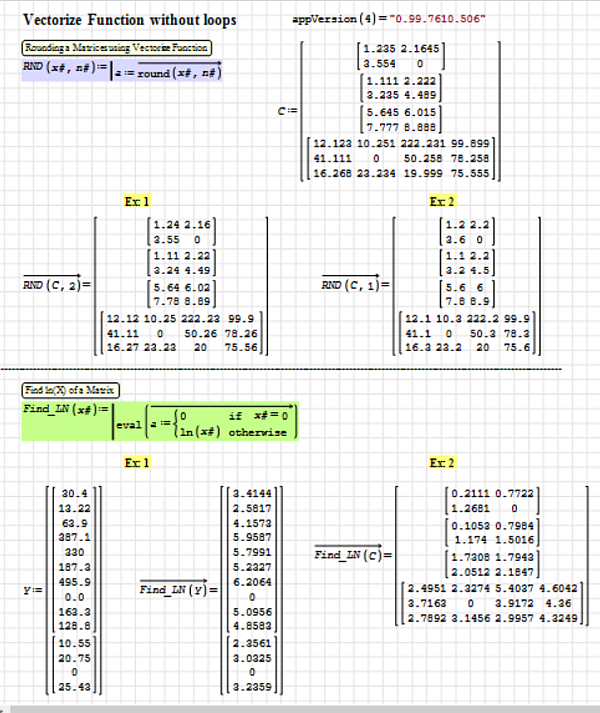

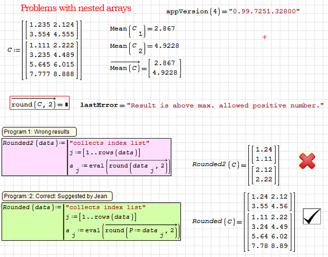

#12 Опубликовано: 08.11.2020 09:58:14
NDTM Amarasekera
NDTM Amarasekera
here are some more issues with the vectorize function
Vectorize function without loops.
Vectorize_Eady.sm (15,01 КиБ) скачан 1483 раз(а).
