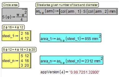

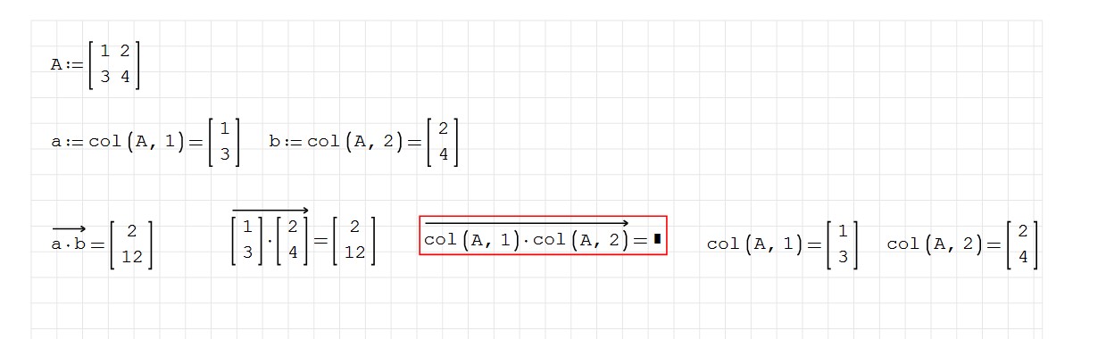

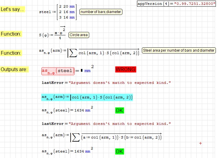

I am having this issue evaluating the vectorized multiplication:
I don't know what the problem could be. I started today switching definitely from Mathcad Prime 5 and started rewriting some codes.
Really happy with the decision I made, and also with the latest SMath studio version, I am running 0.99.7251 SMath.
Thank you in advance for your help,
Alvaro Gavilán
Vectorize.sm (6,15 КиБ) скачан 1465 раз(а).

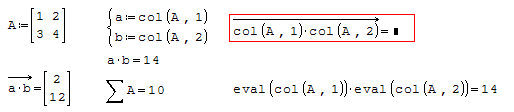

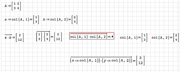

Matrices are multiplied like in a matcade
Project SteelBar.sm (7,73 КиБ) скачан 1495 раз(а).
Thank you Jean for your suggestion.
I would rather use a function, because in various parts of my worksheet (beam design), I need that function. It would be like this:
AG24042020-Steel area.sm (6,48 КиБ) скачан 1437 раз(а).

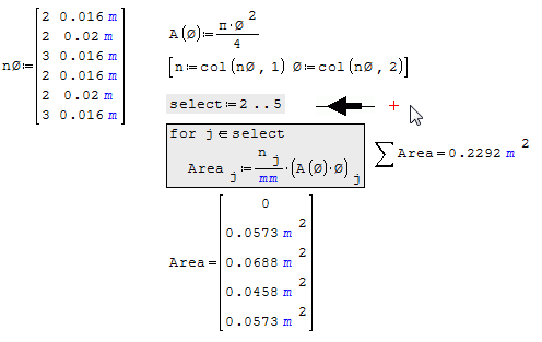

WroteI would rather use a function,
Maybe like this.
Project SteelBar.sm (23,19 КиБ) скачан 1473 раз(а).

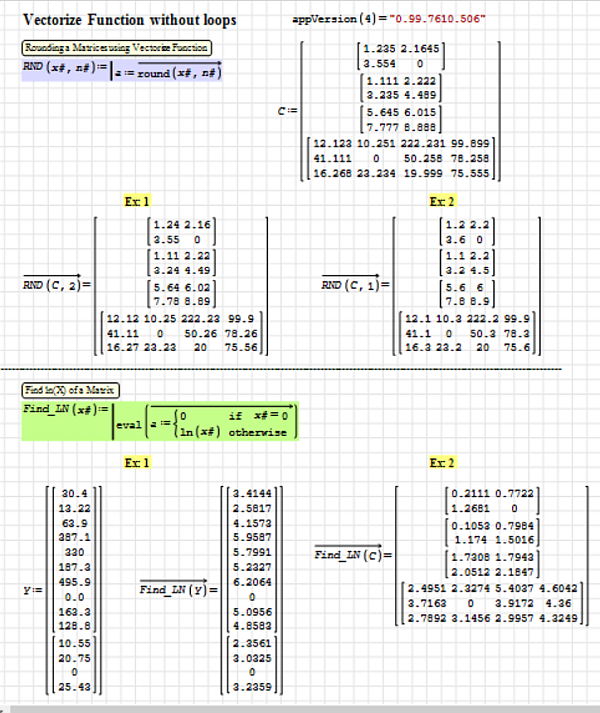

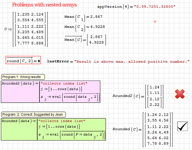

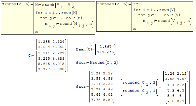

Wrotehere are some more issues with the vectorize function
Vectorize function without loops.
Vectorize_Eady.sm (15,01 КиБ) скачан 1395 раз(а).
