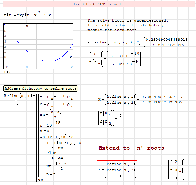

Here is a decent answer: it is known in mathematics that solving for
root(s) and by same token solving for "root(s) intersection" is a
difficult task. For instance, in Mathcad we may get no answer if TOL
is not compatible. It may be as low as default 0.001 and get exact
root. But it may require much lower TOL. Maxima "solve" is no different
maths wise. They have simplified the block by not including user TOL,
and probably concluded that TOL= 10e-9 was generally good enough.
In various applications, "Maxima solve" gets exact root(s) or not better
than 10e-8.

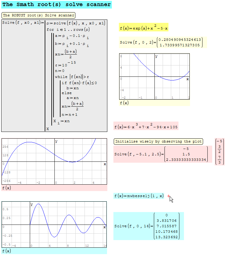

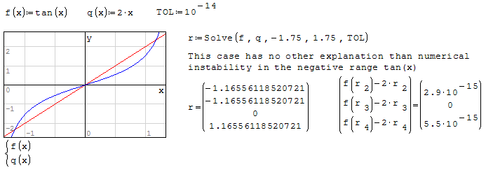

This revised version includes user TOL in the solver. Some examples support
TOL 10e-14 ... other only 10e-12. In any case it should solve.
The two solvers are given: root(s) & "root(s) intersection"
