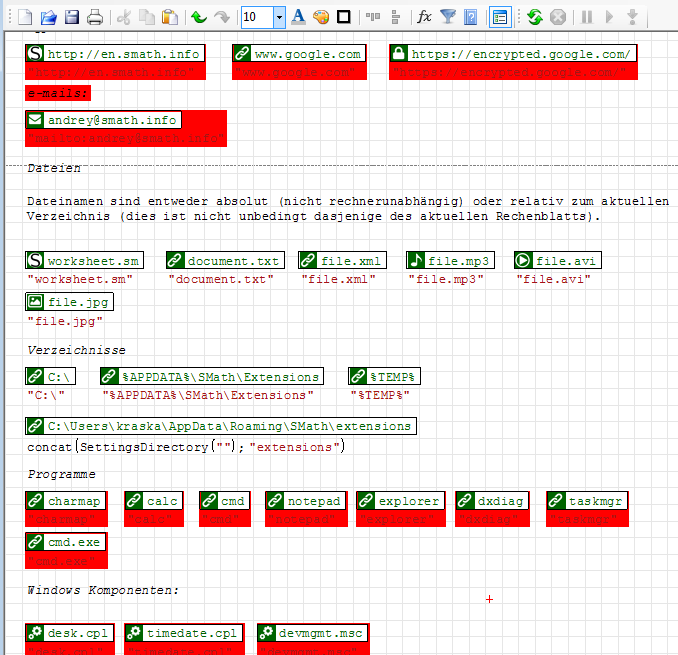

Davide, I experience strange problems with hyperlinks with SMath 0.98.6179 and a fresh hyperlink region plugin.
The links in your docs (from post #1) work fine.
If I copy them to my handbook page, I get "System can't find the file" messages for the links marked with red background, both documents in the same instance of SMath. No matter if portable or installed distribution...
There must be something wrong with my document...
Davide Carpi 02.01.2017 12:35:00, Serg 02.01.2017 13:06:00
#43 Опубликовано: 02.01.2017 12:35:03
Try now, it should be fixed.

#44 Опубликовано: 02.01.2017 13:10:41
1 360 сообщений из 2 275 понравились пользователям.
Confired, thank you.

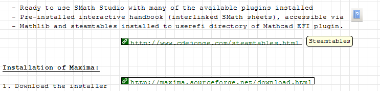

#56 Опубликовано: 26.09.2018 14:48:08
The link text seems to be cut off in 6824 and newer (perhaps also older).
Davide Carpi 27.09.2018 07:06:00
#57 Опубликовано: 26.09.2018 19:07:46
Thank you Martin, confirmed and fixed.
