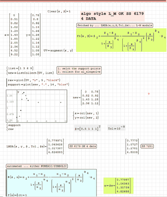

Carlos, my dear friend,
SS 6179 has found his Waterloo from your latest LM algo style,
but works fine from your original [2018] piece wise.
Seemingly the matter is some numerical issue,
but couldn't doctor that poisoned patient.
You know: can't doctor a stone ... too dead for too long !
No more worry, all the fits in my collection are done.
Still, LM is interesting.
Cheers ... Jean, take care and always be good.

Dear friend Jean.
The problem in the calculation of the second LM algorithm in SS6179
occurs in the calculation of the Jacobian matrix for finite differences,
since in this step, after several iterations, for over unknown reasons an
overflow error occurs (possibly a calculation engine error ).
I have slightly modified the LMSA function and I have been able to solve the
problem indicated with 4 data. The solution that uses all the data is not possible in SS6179.
Solved LM SS 6179.sm (147,18 КиБ) скачан 1319 раз(а).
I hope you feel comfortable with this.
Thanks Carlos for doctoring LMSA SS 6179.
You are right: some numerical issues between versions.
That was most noticed between the two SS 5346 Official
and SS 5346 UNofficial ... this version cured all "Official"
Included in the next Compendium Genfit Classroom Essentials
Genfit_11 Pharmacokinetics LMSA ... LM.sm (76,67 КиБ) скачан 1291 раз(а).
