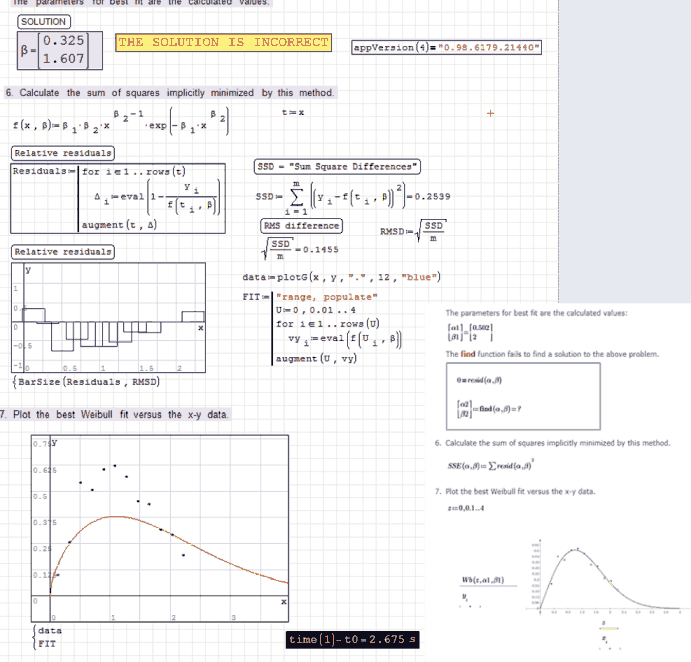

Reviewing the Levenberg Marquardt Method with a Jacobian matrix for finite differences,
solving an example taken from the website:
http://support.ptc.com/help/mathcad/en/index.html#page/PTC_Mathcad_Help/example_using_minerr_for_nonlinear_least_squares_fitting.htm .
Algorithm_Levenberg_M_with_DF_SS7251.sm (210,01 КиБ) скачан 1351 раз(а).

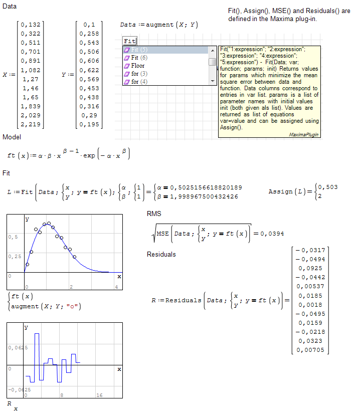

Solution using the Maxima package lsquares via the interface functions of the Maxima plugin
fit1.sm (29,42 КиБ) скачан 1329 раз(а).
frapuano 21.12.2019 15:16:00, Radovan Omorjan 21.12.2019 10:36:00

I post again the version of the algorithm in SS7251 with some minor changes.
Algorithm_Levenberg_M_with_DF_SS6179.sm (513,58 КиБ) скачан 1367 раз(а).
Algorithm_Levenberg_M_with_DF_SS7251_R1.sm (209,94 КиБ) скачан 1382 раз(а).

The question is: Why does the SS7251 version directly obtain the solution,
changing the values correctly of the β variable, while the SS6179 version does not,
and they have to be manually entered as new values of the vector of the assumed initial solution. ?
The algorithm is the same for the 2 versions of SmathStudio, so what is the difference if the
programming and decision definitions are supposed to work the same?

Hola Carlos. Just check the code from the SS6179 version, in the while not(stop) loop, the line with A:=J^T*f is wrong, it must to be A:=J^T*J.
NDTM Amarasekera 27.12.2019 07:17:00

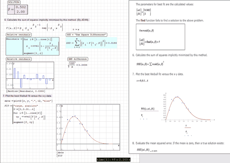

Thanks Alvaro ... doctored !
Weibull LM [0.1,1] 1 min
Weibull CG [0.1,1] 2.3 sec ... ½ max residual deviation
Carlos, your very original LM [Pharmacokinetics] works faster.
an it be compacted algo style ... tried not to avail ?
Hola ! Avaro, Carlos ... Jean
Genfit Weibull [LM_Iteretive CG].sm (437,44 КиБ) скачан 1153 раз(а).
Genfit [Algo Minimize(L-M)].sm (116,99 КиБ) скачан 1150 раз(а).
Hola Alvaro.
Muchas gracias por tu corrección.
Cuando copie y pegue directamente el codigo de SS7251 a SS6179 daba el error de
"Ecuacion demasiado larga para visualizarla" con un tiempo de ejecusion de mas de 7 minutos,
por lo que opté por copiar manualmente el codigo, pensando que las declaraciones eran interpretados erroneamente, y
fue cuando copie mal la formula.
Hello Alvaro.
Thank you very much for your correction.
When copying and pasting directly the code from SS7251 to SS6179 it gave the error of
"Equation too long to display" with an execution time of more than 7 minutes,
So I chose to manually copy the code, thinking that the statements were misinterpreted, and
It was when I copied the formula badly.

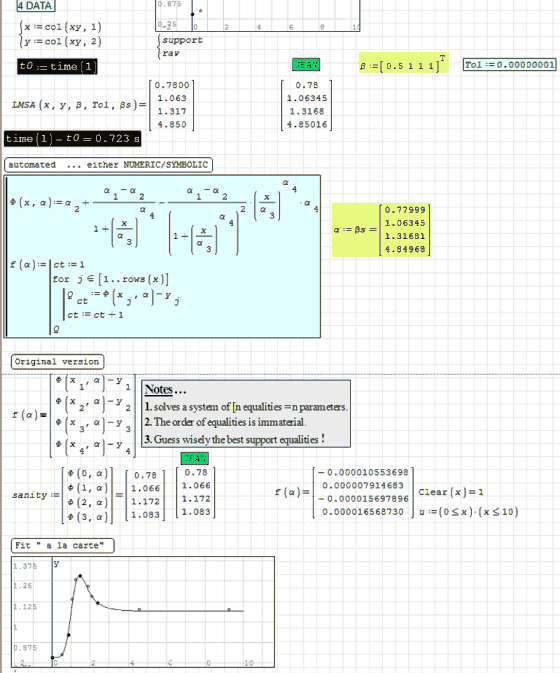

The second Levenberg Marquardt algorithm has been passed as a function
in the versions of SS7251 and SS6179, the examples published by Jean in
"Genfit linfit HyperRobust [Ge Crystal] .sm"
and 2 other previous examples have also been solved.
Unfortunately, version SS6179, for unknown reasons
does not solve the first example, and results in the
same starting solution vector, the other examples are solved without problem.
LM2A_as_a_Function_SS7251.sm (150,91 КиБ) скачан 1337 раз(а).
LM2A_as_a_Function_SS6179.sm (144,14 КиБ) скачан 1333 раз(а).
Hola ! Carlos.
You don't specify if the SS 7251 solves that example.
Please, don't drop dead at reading.
This example attached, Mathcad [L-M, CG, QN] does not even
return the exact coefficients. I tortured myself on that.
On the other hand as well, many model functions can't be
fitted from being too much reflexive within themselves.
For those non willing fit, al_nleqsolve will generally succeeds.
Mathcad failed as well the ITER Cadarache Cu resistivity.
Was done otherwise via sub methods. At least for ITER,
Mathcad returned: "Too complicated to solve"
u:=(0≤x)*(x≤10) useful constrain the Quick plot.
Thanks for your immense dedication.
Genfit [Algo Minimize(al_nleqsolve Pharmacokinetics) ... AUTOMATED] Copy.sm (104,24 КиБ) скачан 1078 раз(а).

Levenberg Marquardt's second algorithm in SS7251 does solve the example. All data
with a tolerance of 10 ^ -16 can be used, or 4 selected data with a tolerance of
10 ^ -8 can be used, in both cases, the starting vector is [0.5 1 1 1].
LM2A_as_a_Function_SS7251_R1.pdf (798,89 КиБ) скачан 859 раз(а).
LM2A_as_a_Function_SS7251_R1.sm (205,62 КиБ) скачан 1351 раз(а).
The idea was to run the LM algorithm as a function for SS7251 and SS6179, for which

#20 Опубликовано: 16.01.2020 15:35:31
Jean, I tell you that I take the results you show in your exercises as the exact or correct ones
They are all correct, good fit from model.
There are many more techniques to best fit by region(s)
The last example SS 6179 spits the fit very fast vs other
solvable previous examples ... supports tol 0.00000001.
Comfort yourself: model fit needs no more than 6 decimals
or less ... from zillions done.
Thanks Carlos for your doctoring expertise.
