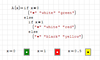

You're right Radovan, and you can also nest many if/else to have multiple outputs

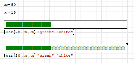

Please find attached a brick for bar charts. Please note that I was forced to fill the right of the bar by visible symbols as spaces obviously are disregarded for computing the region size.
Example cfregion barchart.sm (4,95 КиБ) скачан 2107 раз(а).
Radovan Omorjan 30.09.2013 14:51:00
I can force the plugin to measure also the trailing spaces, if could be useful, just let me know it
best regards,
Davide
2013-09-30 20_38_18-SMath Studio Desktop - [Example cfregion barchart.sm].png
Radovan Omorjan 30.09.2013 14:52:00
#7 Опубликовано: 30.09.2013 15:04:25
Done, updated

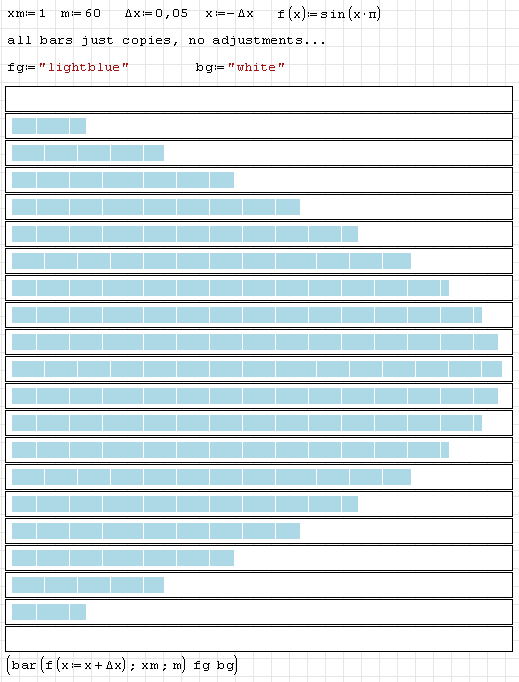

Now the complete bar chart.

#10 Опубликовано: 02.10.2013 04:22:38
Thanks for the update.
As you see, the region can display multiline text, thus it would be possible to do stuff like the bar chart in a single region, if there was access to the newline character from the GUI.
I'd propose to accept a single string as argument, now as there are defaults for the colors.
I also propose to left align the text (or to provide optional control)

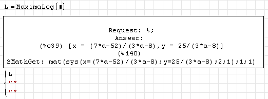

The maxima plugin has a two-level log inspection feature:
  1. MaximaLog("all" ) displays the entire Maxima session from the Maxima perspective without translation detail)
  2. MaximaLog(#) displays the detail of the previous Maxima call including maxima command, maxima response and back-translation.
By positioning the MaximaLog(#) at the right place you can clearly tell what Maxima did in the last interaction, regardless if the call was made by a hijacked function like int(), diff(), sum() or lim(), a dedicated function like Solve() or LinSolve() or directly by a Maxima() command.
I found MaximaLog(#) handy to use for documenting bugs in the todo list and it is always close at hand (from the dynamic assistant) in the sheet without the need to open and close the output window.
I must admit that I don't know how to even reach this level of comfort and clearness using the output window. How would you control the output if not by dedicated commands? How would you identify where the output came from? When using trace(), I find myself adding label texts to output commands in order to match the output with the SMath context. But I may just oversee options, thus any ideas are welcome.

The multiline feature is not easily accessible from the canvas, so the alignment feature would produce confusion (in some way like the resize's grips); BTW if you want a "display region" to send out a well formatted output from the Maxima plugin, you can also make something like the "Maple" region of Viacheslav
I suppose your proposal impies that the output window can be fed directly from inside plugins. How would I trigger this from outside? How do I identify the output of a particular math region in the midst of a SMath sheet? I can't stop the re-calculation of a sheet at a particular expression, can I?
Sincerely I don't know, I've threw a stone into the pond
Maybe a special context menu item could be added or a log function with canvas free result that enable the output window output, or something else
BTW looking back my previous post Log files are useful for crashes (deep debugging -> plugin's developpers)

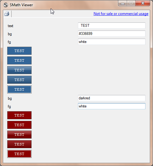

#16 Опубликовано: 25.10.2013 11:39:06
UPDATED
- small fixes
- added styles (optional 4th argument)
