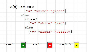

You're right Radovan, and you can also nest many if/else to have multiple outputs

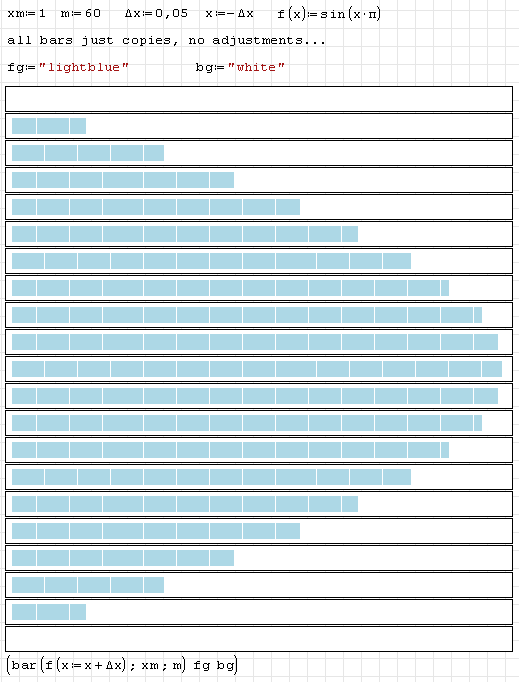

Please find attached a brick for bar charts. Please note that I was forced to fill the right of the bar by visible symbols as spaces obviously are disregarded for computing the region size.
Example cfregion barchart.sm (4.95 KiB) downloaded 2107 time(s).

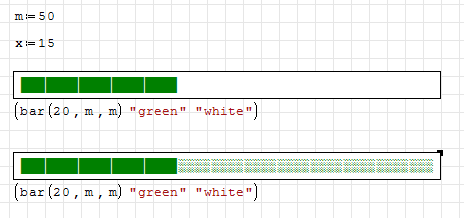

I can force the plugin to measure also the trailing spaces, if could be useful, just let me know it
Done, updated

Now the complete bar chart.
Davide Carpi 9/30/2013 5:17:00 PM, Radovan Omorjan 10/1/2013 4:46:00 AM

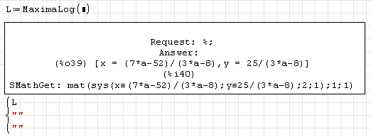

The maxima plugin has a two-level log inspection feature:
  1. MaximaLog("all" ) displays the entire Maxima session from the Maxima perspective without translation detail)
  2. MaximaLog(#) displays the detail of the previous Maxima call including maxima command, maxima response and back-translation.
By positioning the MaximaLog(#) at the right place you can clearly tell what Maxima did in the last interaction, regardless if the call was made by a hijacked function like int(), diff(), sum() or lim(), a dedicated function like Solve() or LinSolve() or directly by a Maxima() command.
I found MaximaLog(#) handy to use for documenting bugs in the todo list and it is always close at hand (from the dynamic assistant) in the sheet without the need to open and close the output window.
I must admit that I don't know how to even reach this level of comfort and clearness using the output window. How would you control the output if not by dedicated commands? How would you identify where the output came from? When using trace(), I find myself adding label texts to output commands in order to match the output with the SMath context. But I may just oversee options, thus any ideas are welcome.

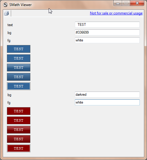

- small fixes
- added styles (optional 4th argument)
