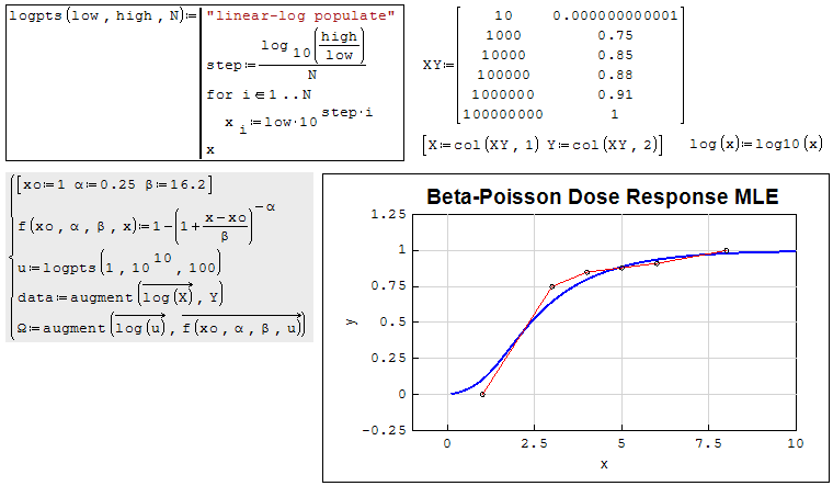

Wrote... else than Bode.
... more USER
Utilities logpts [Beta_Poisson].sm (13,52 КиБ) скачан 1032 раз(а).

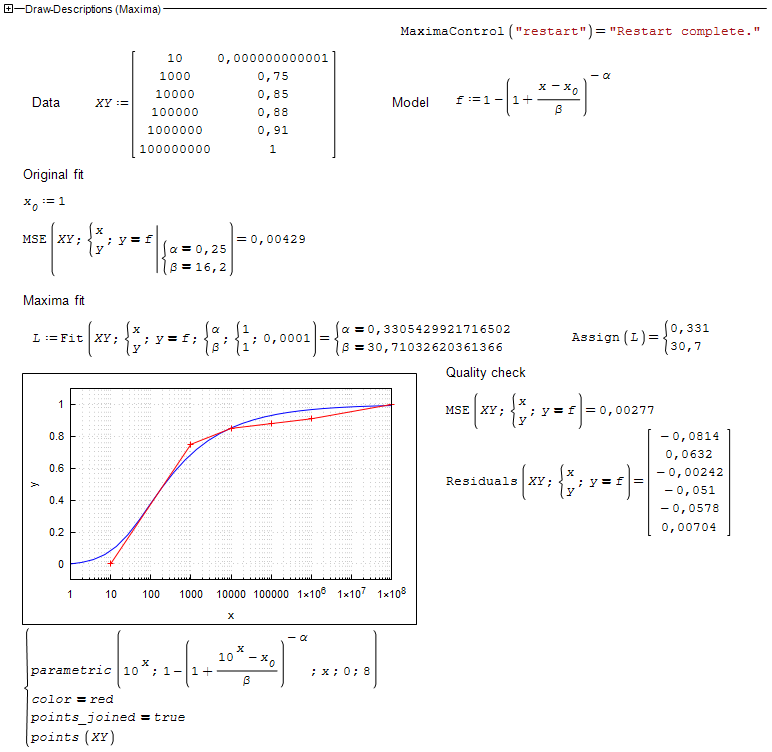

Here is a Maxima version, including the fit procedure. Note the use of parametric() in order to get evenly distributed points in the log plot.
logplot.sm (145,83 КиБ) скачан 1312 раз(а).
WroteHere is a Maxima version, including the fit procedure. Note the use of parametric() in order to get evenly distributed points in the log plot.
Thanks Martin.
1. added the source experiment notes
2. added Weibull MLE example.
Utilities logpts [Beta_Poisson].sm (353,86 КиБ) скачан 1162 раз(а).
