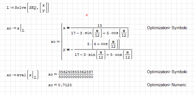

How to turn of the decimal values in trygonometry angles value? I got sth lik this for solution of system of equations:
The file with example: example_v1.sm (8 КиБ) скачан 1201 раз(а).

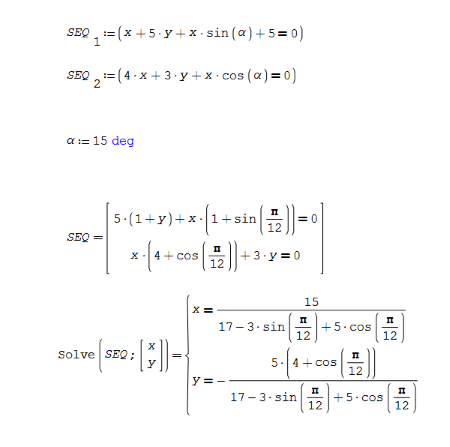

#3 Опубликовано: 09.09.2021 09:52:40
How to turn of the decimal values in trigonometry angles value ?
By default, trig are in decimal radian in all CAS.
Recast your solutions, fill-in the unit place holder.

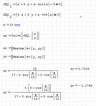

Hi. You also can use Maxima commands, in this case ev():

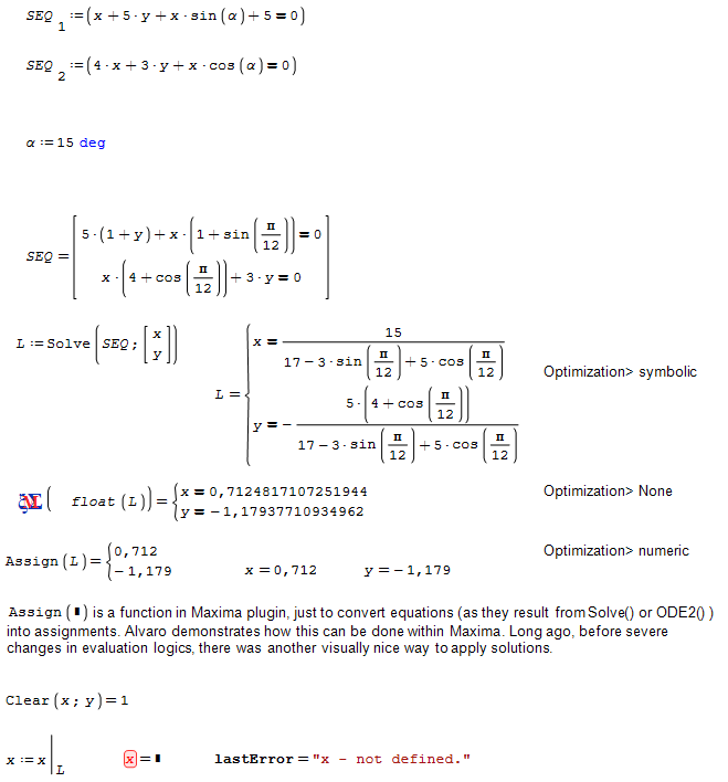

#5 Опубликовано: 10.09.2021 05:37:18
example_v1.sm (13,63 КиБ) скачан 1214 раз(а).
sergio 10.09.2021 06:11:00
#6 Опубликовано: 10.09.2021 13:02:39
Hi Martin. I use Maxima's ev() because SMath's Assign() only works with the variable names, instead others, like xo, yo, and SMath's at() doesn't works for the symbolic evaluation, as shown this picture:
example_v1.sm (15,95 КиБ) скачан 1193 раз(а).

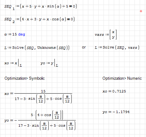

This is a workaround for use only SMath native functions or plugins, without any explicit Maxima function:
example_v2.sm (15,16 КиБ) скачан 1262 раз(а).
